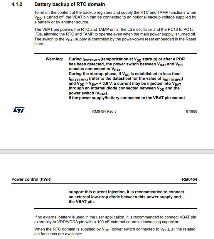

Dear @gtimmen ,
Is that possible to know VDD and VBAT values ?  and how the switching is managed from VBAT to VDD.
During the switching phase of VBAT domain to be powered by VDD the switch is connected to VBAT
STM32G0x0 advanced Arm®-based 32-bit MCUs - Reference manual
Hope it helps.
STOne-32.

@STOne-32 The VDD is about 3.290V and the VBAT is 3.245V. The tRSTTEMPO max is 400us and i have a 1uF capacitor on VBAT.
