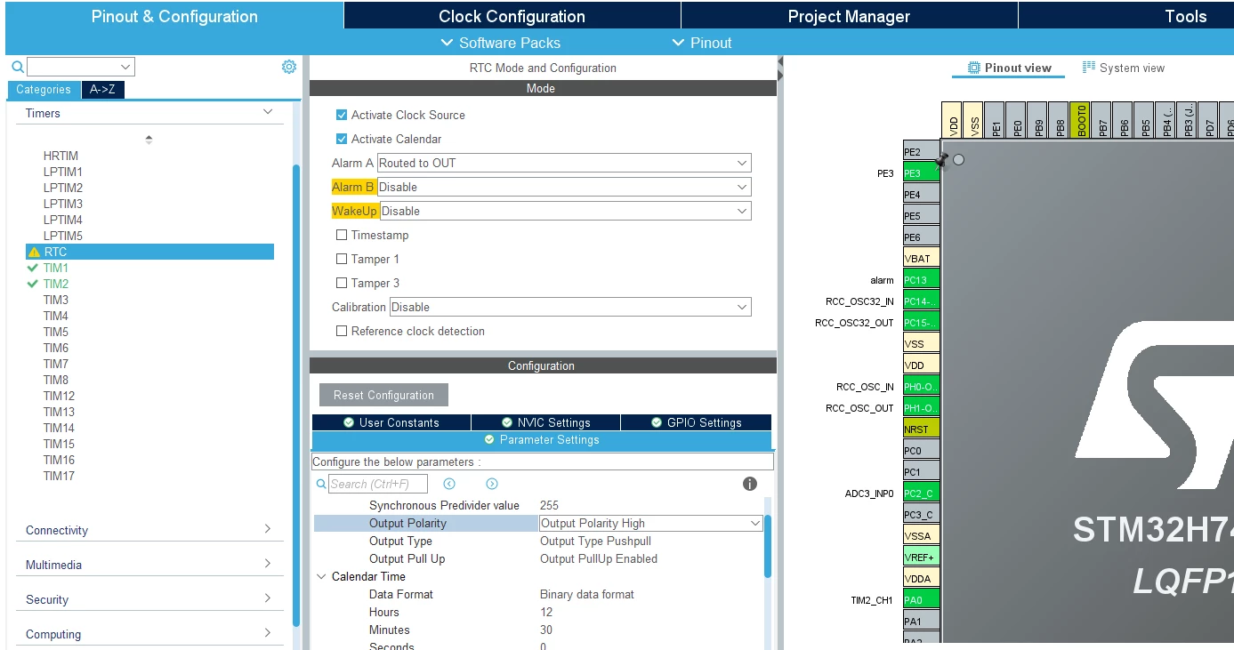

Hi, I am trying to get an alarm signal on pc13 pin but without success, could you give an example? I turn on alarm A (Routed to OUT), the interrupt occurs but nothing changes on the output.Screenshot_8.png

Hello Denys_T,
Firstly, may I ask if you are using a Nucleo board ?
If it's the case, I do think, it's normal cause PC13 is connected to the user button. You can remove SB51. You could  try it routed to the second output, PB2, but I do think you need to remove SB63.
Also note the output are not available, if you don't use the alarm with the interruption, meaning it doesn't work in polling mode.
Have a nice one,
February 12, 2024
It seems I found what was wrong, I carried out tests without turning off VDD and expected to see a signal on PC13 but nothing happened, but as soon as I turned off VDD the alarm signal appeared =))
