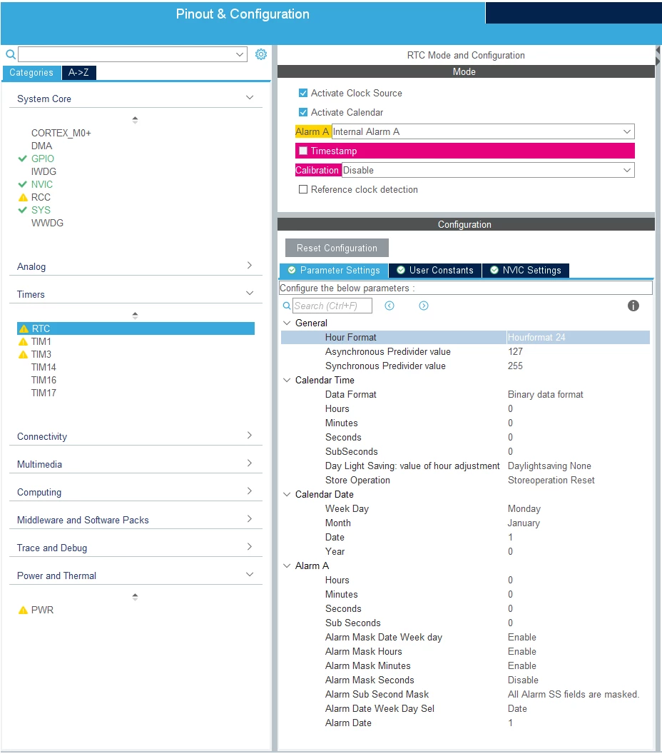

I have found various guides on how to configure the RTC as wakeup-source. However, they do not seem to apply to the C0 family.
In the CubeIDE I cannot find the depicted settings on RTC, (most notably, no option to select internal wakeup and configure wakeup counter and clock)
Is this not implemented on the C0 family?
I just want my MCU to wake up from sleep mode every x milliseconds. What else can I do to implement this on a C011?
Thanks
Lucas

Let's switch from register level to a STM32CubeMX generated project using HAL.
Generate a new project, I used STM32C0116-DK for example with all default settings.
Activate a periodic RTC alarm once per minute, date and time don't matter.
The generated code will already activate that alarm in MX_RTC_Init();
Add code in main.c while loop:
 /* USER CODE BEGIN WHILE */
 while (1) {
 HAL_GPIO_TogglePin(LED_GPIO_Port, LED_Pin);
 HAL_SuspendTick();
 HAL_PWREx_EnableInternalWakeUpLine();
 HAL_PWR_EnterSTOPMode(PWR_MAINREGULATOR_ON, PWR_STOPENTRY_WFE);
 SystemClock_Config();
 HAL_ResumeTick();
 /* USER CODE END WHILE */
 /* USER CODE BEGIN 3 */
 /* USER CODE END 3 */
Build and run the code. The on-board LED will toggle once per minute.
For reference I have attached the .ioc file used for code generation.
For you own designs: make sure that the RTC runs on LSI clock.
hth

How can I set a different time?
My RTC Init looks like this
 * @brief RTC Initialization Function
 * @PAram None
 * @retval None
static void MX_RTC_Init(void)
 /* USER CODE BEGIN RTC_Init 0 */
 /* USER CODE END RTC_Init 0 */
 RTC_TimeTypeDef sTime = {0};
 RTC_DateTypeDef sDate = {0};
 RTC_AlarmTypeDef sAlarm = {0};
 /* USER CODE BEGIN RTC_Init 1 */
 /* USER CODE END RTC_Init 1 */
 /** Initialize RTC Only
 hrtc.Instance = RTC;
 hrtc.Init.HourFormat = RTC_HOURFORMAT_24;
 hrtc.Init.AsynchPrediv = 127;
 hrtc.Init.SynchPrediv = 255;
 hrtc.Init.OutPut = RTC_OUTPUT_DISABLE;
 hrtc.Init.OutPutRemap = RTC_OUTPUT_REMAP_NONE;
 hrtc.Init.OutPutPolarity = RTC_OUTPUT_POLARITY_HIGH;
 hrtc.Init.OutPutType = RTC_OUTPUT_TYPE_OPENDRAIN;
 hrtc.Init.OutPutPullUp = RTC_OUTPUT_PULLUP_NONE;
 if (HAL_RTC_Init(&hrtc) != HAL_OK)
 Error_Handler();
 /* USER CODE BEGIN Check_RTC_BKUP */
 /* USER CODE END Check_RTC_BKUP */
 /** Initialize RTC and set the Time and Date
 sTime.Hours = 0;
 sTime.Minutes = 0;
 sTime.Seconds = 0;
 sTime.SubSeconds = 0;
 sTime.DayLightSaving = RTC_DAYLIGHTSAVING_NONE;
 sTime.StoreOperation = RTC_STOREOPERATION_RESET;
 if (HAL_RTC_SetTime(&hrtc, &sTime, RTC_FORMAT_BIN) != HAL_OK)
 Error_Handler();
 sDate.WeekDay = RTC_WEEKDAY_MONDAY;
 sDate.Month = RTC_MONTH_JANUARY;
 sDate.Date = 1;
 sDate.Year = 0;
 if (HAL_RTC_SetDate(&hrtc, &sDate, RTC_FORMAT_BIN) != HAL_OK)
 Error_Handler();
 /** Enable the Alarm A
 sAlarm.AlarmTime.Hours = 0;
 sAlarm.AlarmTime.Minutes = 0;
 sAlarm.AlarmTime.Seconds = 0;
 sAlarm.AlarmTime.SubSeconds = 0;
 sAlarm.AlarmTime.DayLightSaving = RTC_DAYLIGHTSAVING_NONE;
 sAlarm.AlarmTime.StoreOperation = RTC_STOREOPERATION_RESET;
 sAlarm.AlarmMask = RTC_ALARMMASK_ALL;
 sAlarm.AlarmSubSecondMask = RTC_ALARMSUBSECONDMASK_ALL;
 sAlarm.AlarmDateWeekDaySel = RTC_ALARMDATEWEEKDAYSEL_DATE;
 sAlarm.AlarmDateWeekDay = 1;
 sAlarm.Alarm = RTC_ALARM_A;
 if (HAL_RTC_SetAlarm_IT(&hrtc, &sAlarm, RTC_FORMAT_BIN) != HAL_OK)
 Error_Handler();
 /* USER CODE BEGIN RTC_Init 2 */
 /* USER CODE END RTC_Init 2 */
I've already changed the IOC so that "Alarm Mask Seconds" is alos enabled. Now it flashes once per second, not per minute. But how can I set a custom time? I tried playing around with the RTC Init but could'nt achieve a different timing.
Ideally, I want to use it in the subsecond domain (to get the MCU to sleep for a few us every time) but I guess the logic is the same once I understand how it's done.
Thanks
Lucas
PandaAuthor
Jun 22, 2025 10:23 PM UTC
I have re-read it and I think my question might be unclear. I want to set a custom duration for the alarm, so that foir example it will wake up after 5 seconds instead of 1.
KnarfB
Jun 23, 2025 7:02 PM UTC
There is no RTC periodic alarm feature for arbitrary time intervals.
The RTC deals with absolute time & date like a wall clock. In general, you have to set the next alarm individually by setting all appropriate registers.
For shorter intervals of periodic wakeup I would recommend using the independent watchdog (IWDG).
hth
