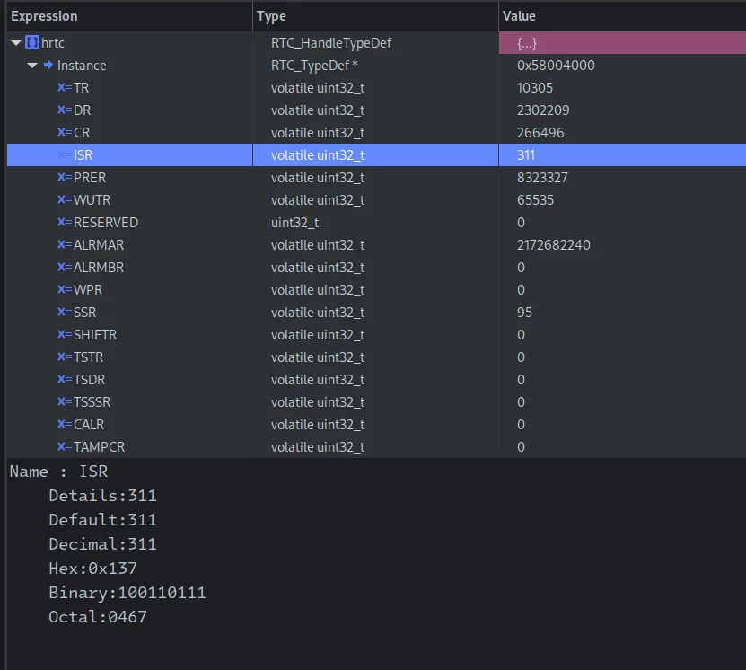

I still have nothing. Seems like the HAL functions to perform all the actions called for in the datasheet.
  • Clear the interrupt on the Alarm
  • Clear EXTI interrupt
  • Write to protection registers
  • Re-enable the interrupt
ISR Flag does not clear:
Still can only get a single interrupt. Single alarm handler, that's it..... Please advise.

Richard Lowe
Richard LoweAuthorBest answer
Senior II
October 18, 2023
The following lines will disable the RTC and cause all my issues:
HAL_PWR_EnableBkUpAccess();
HAL_RTCEx_BKUPWrite(hrtc, RTC_BKP_DR1, ++hobb_time);
HAL_PWR_DisableBkUpAccess();
The first line is already called in the RTC_Init() function, but the the last line, HAL_PWR_DisableBkUpAccess() will disable the RTC..... So that is why it was only called once.
