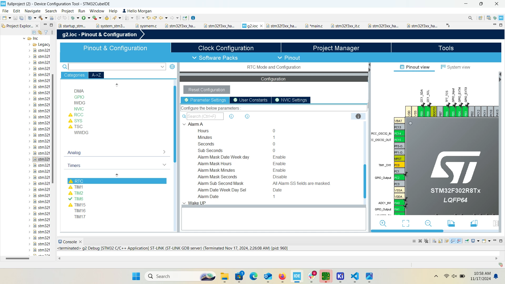

RTC Alarm Callback Double Firing

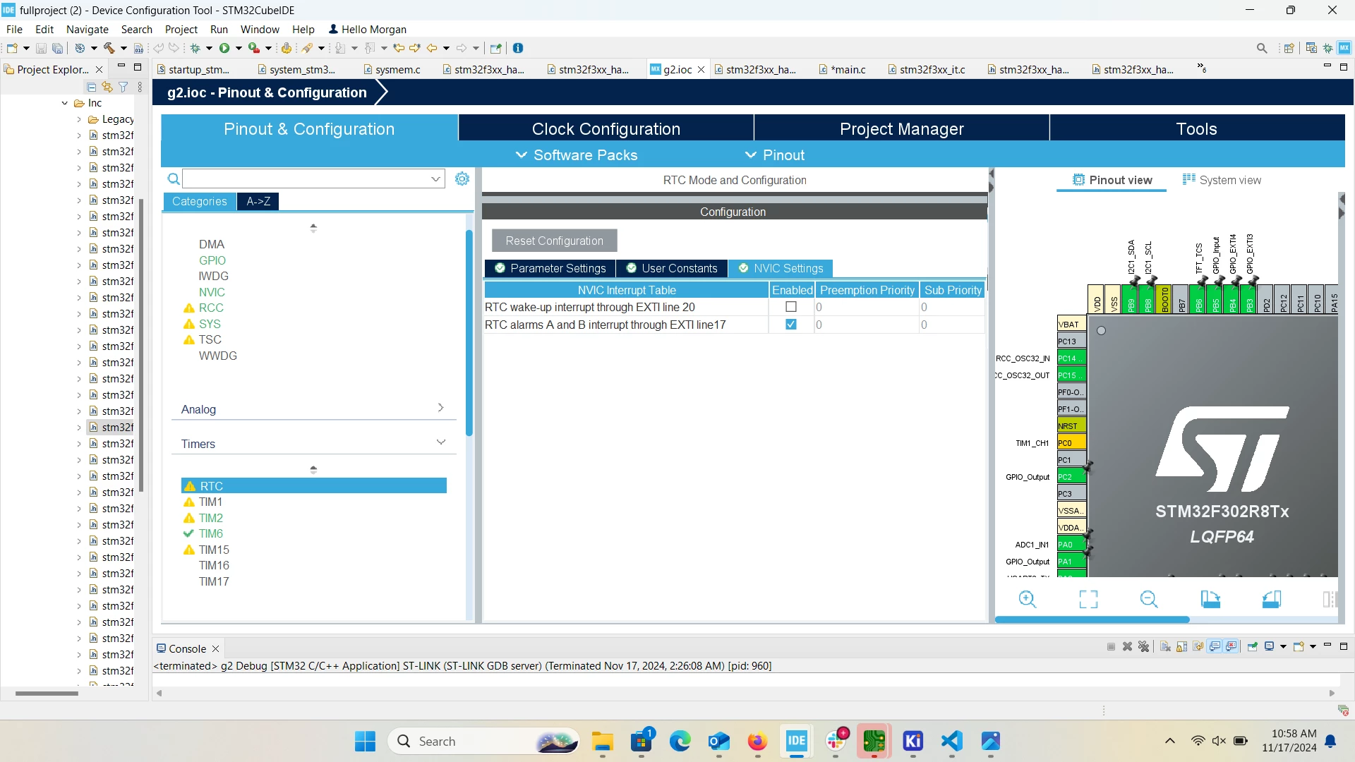

The name. Basically using RTC interrupts to run the call back function every minute and increment a minute counter to do stuff with. However sometimes the minute double fires. There was a post regarding TIM2 firing twice and I tried to clear RTC flags in the call back with no good results(still firing twice). I will post my call back code and image of the alarm configuration. Thanks
