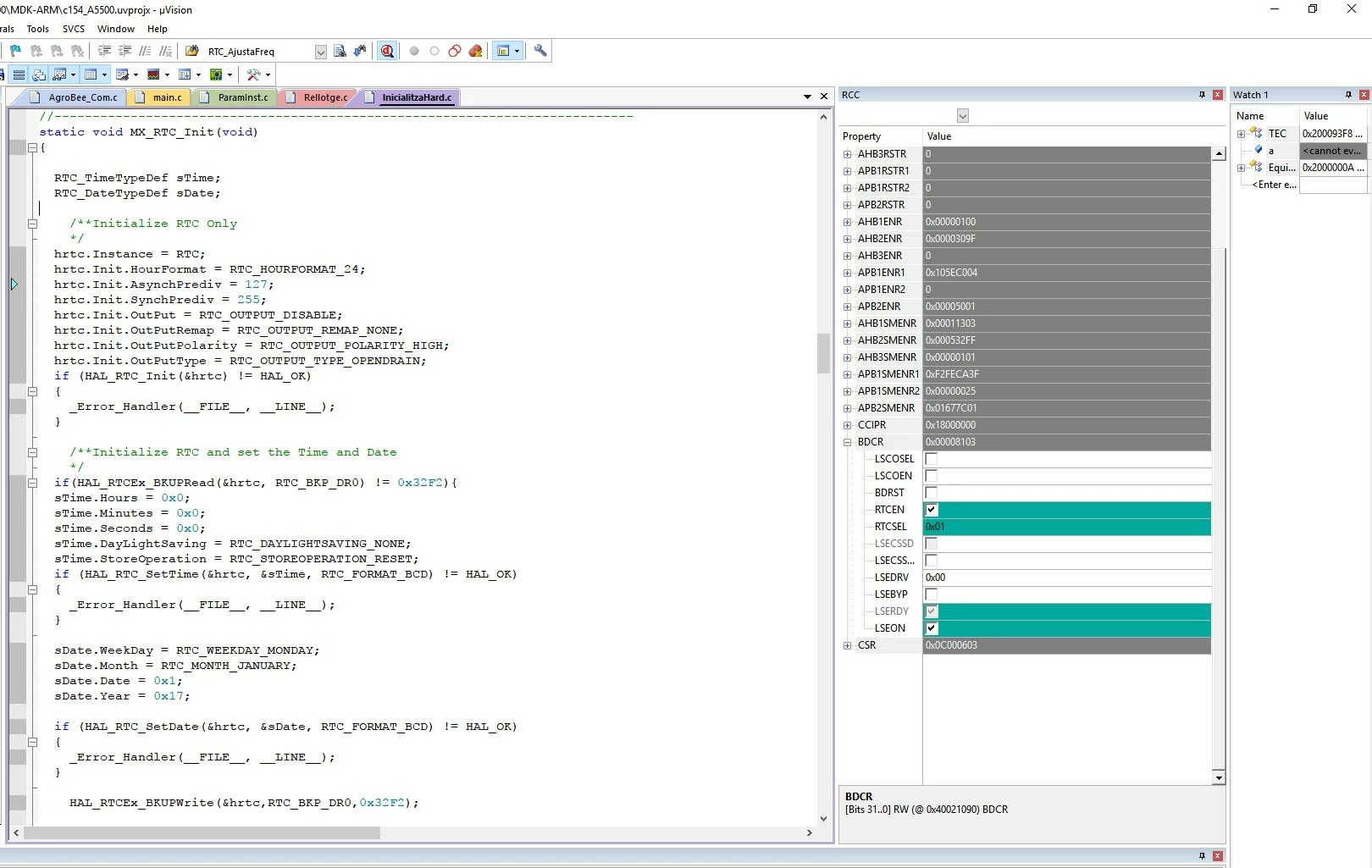

What's the content of RCC_BDCR?
dtarrago
dtarragoAuthor
August 29, 2017

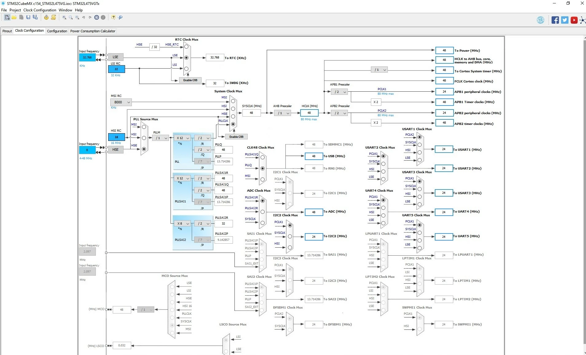

Posted on August 29, 2017 at 15:20
Here you have a screenshot (debugging session) showing this register as well as the initialization code and a second image where Cube clock configuration is also shown.
Best regards.

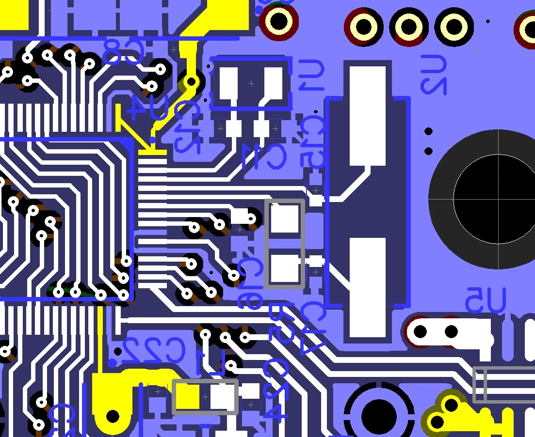

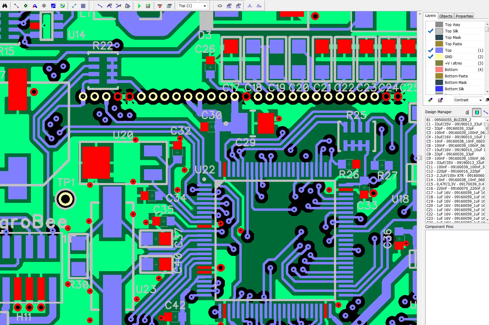

I summarize here below our current status with this issue:
- For the pcb we have been talking about, we have sensed LSE frequency (pin PA2) and read frequency is about 32.518KHz.
- We have just received a different pcb (based on same micro) and we have tested it: in this case, the read frequency at PA2 pin is correct. Being in this situation, we have also enabled PC13 for the 512Hz calibration output --> this makes the PA2 to be 32.5KHz and PC13 is about 508Hz. In the same situatiuon, if 512Hz output is mapped to PB2 (instead of PC13), then we get 32.1768KHz (PA2) and 512Hz (PB2). So, it seems that PC13 is coupled with crystal IN/OUT when it is enabled as a calibration ouput.
Apart of this, and in order to guess what it is happening with the first pcb, please find here below a screenshot of both pcbs: the one we have been talking about and the second one, where crystal is working fine. What is your opinion?
Best regards,
Dani.
Tesla DeLorean
Guru
August 30, 2017
Posted on August 30, 2017 at 15:02
What's the U1 crystal part on board ♯ 2
I prefer how the capacitors are routed on the second design.
waclawek.jan
August 30, 2017
Posted on August 30, 2017 at 15:41
VBAT is routed how?
dtarrago
dtarragoAuthor
August 30, 2017
Posted on August 30, 2017 at 15:45
It is routed in layer-3: both boards are 4-layer:
    - Layer-1: TOP (components and signal routing)
    - Layer-2: GND
    - Layer-3: Power/Voltage lines
    - Layer-4: Signal routing
waclawek.jan
August 30, 2017
Posted on August 30, 2017 at 15:57
Okay but where is it connected to? A battery? Is there anything else connected to that line? How is its return routed?
Note that VBAT pin supplies both the LSE oscillator and the PC13 pin.
If there are significant high-frequency currents flowing in the ground plane, the multiple vias around the crystal may be detrimental, too.
