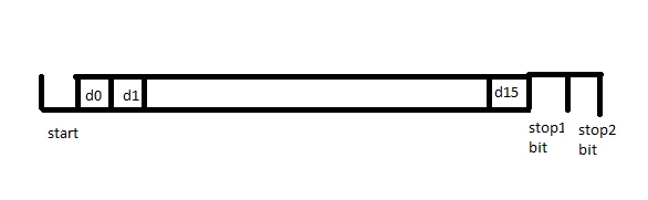

I have a question regarding non standard word length over RS485.
I need to receive next frame over RS485
1 start bit, 16-bit data word, 2 stop bits, in total 19 bits.
UART implementation allows to receive 8 or 9-bit data words.
Could you please advice what can be an approcach to achieve?
Best regards, Taras.

You can't receive this using the native UART in 'F4, so you need to resort to bit-banging, possibly using timer interrupts.
Andrew Neil
October 4, 2024
As @waclawek.jan said, you're going to have to bit-bang this.
You might start by looking at AN4457, Implementing an emulated UART on STM32F4 microcontrollers:
https://www.st.com/resource/en/application_note/an4457-implementing-an-emulated-uart-on-stm32f4-microcontrollers-stmicroelectronics.pdf
and adjust its number of data bits.
It might be possible to synthesise something using the SPI peripheral, but it would rely on being able to accurately control the timing between 2 transfers ...
EDIT: the QSPI can do 32-bit transfers ...

Hi, @Andrew Neil , @waclawek.jan ,
appreciate your suggestions, they pushed me toward the solution.
Actually, I  solved the problem with IC( falling + rising edges ) + DMA. DMA catches CCR2.
ClockFreq=84Mhz
BitRate=2.73Nhz
X = ClockFreq / BitRate gives me [ticks/bit]
And I see the difference in clock ticks between every falling  and rising edge.
where c0 - first falling edge, stop bit started
c1 - rising edge, c2 falling edge
(c2 - c1) / X  gives me the number of bits I can set equal to 1.
And of course (c1 - c0) + ( c2 - c1 ) is length of the parcel.

There may be some asymmetry in measured duration of "high" and "low" level due to the edges not being perfectly sharp and the decision level not being exactly at the middle of the edge.
Is that a fatal problem in decoding? Post some concrete values.
