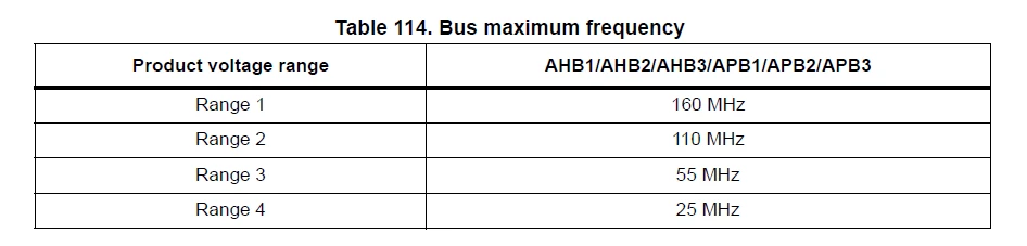

RM0456: 10.5.4 unclear restrictions for STM32U59x/5Ax/5Fx/5Gx devices
RM 0456 10.5.4 Dynamic voltage scaling management writes under "System frequency steps on STM32U59x/5Ax/5Fx/5Gx device"
On STM32U59x/5Ax/5Fx/5Gx devices only, the maximum system frequency increase or
decrease in the VOS range 1 is 80 MHz.
This is unclear to me. On first reading I thought that 80 .. 160 Mhz in range 1 is not possible! Or does this imply a special handling needed when in Range 1 and target frequency is 1..80 MHz while with target frequency 80 .. 160 Mhz the handling explained before is needed?

Hello @Uwe Bonnes ,
The maximum frequencies is shown below (in table 114 of RM0456).
This sentence implies the special handling needed when we are in VOS range1. The 80 Mhz is a key frequency to consider in the sequences of frequency increase or decrease in case of VOS range1:
  • When running at lower frequencies than 80 MHz, If we need to increase the frequency in the VOS range 1 above 80 MHz:
1. Divide the system clock by two, using the AHB prescaler (HPRE = 0b1000
in RCC_CFGR2).
2. Configure and enable the PLL1 if needed.
3. Select PLL1 as system clock source (SW = 0b11 in RCC_CFGR1).
4. Wait for 5 μs.
5. Set the AHB prescaler to 1 (HPRE = 0b0000 in RCC_CFGR2).
  • When running at higher frequencies than 80 MHz and we need to decrease the frequency below 80 Mhz
1. Divide the system clock by two using the AHB prescaler (HPRE = 0b1000
in RCC_CFGR2).
2. Wait for 5 μs.
3. Define the lower speed clock as system clock source.
4. Set the AHB prescaler back to 1 (HPRE = 0b0000 in RCC_CFGR2).
Table 114 of RM0456 summarizes the Busses maximum frequencies:
Best Regards,
Younes
