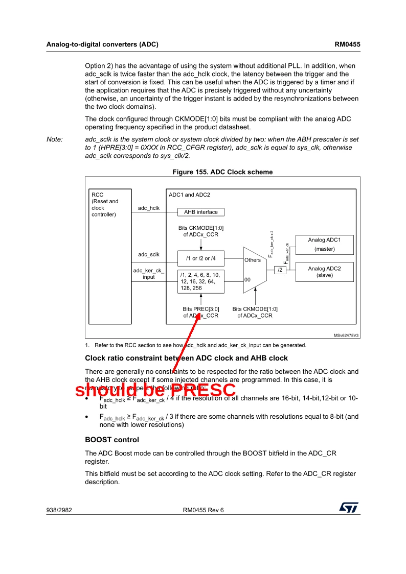

RM0455 Typo in figure describing ADC clock
  • June 2, 2023
  • 1889 views
Should be "PRESC" rather than "PREC"
I did not check but I guess this will be in other RMs too.
Best answer by Diane POMABIA
Hi @Community member​
Thank you for your report. I have informed the concerned team who will do the necessary to correct this error in all RMs that have it.
Regards
Diane

Diane POMABIABest answer
June 2, 2023
Regards
Diane
