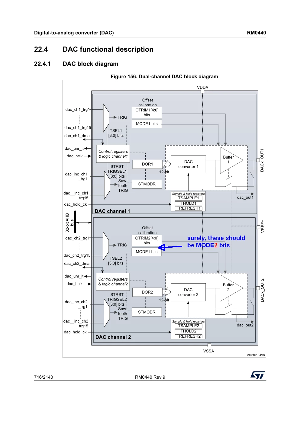

For consistency it should be:
OTRIM1[4:0]
MODE1[2:0]
OTRIM2[20:16]
MODE2[18:16]
mƎALLEm
Oct 9, 2026 8:16 AM UTC
Hello ​@waclawek.jan & ​@MasterT,
Thank you for your contribution. I’ll escalate the case internally for analysis and eventual fix. Internal ticket: CDM0066450.
