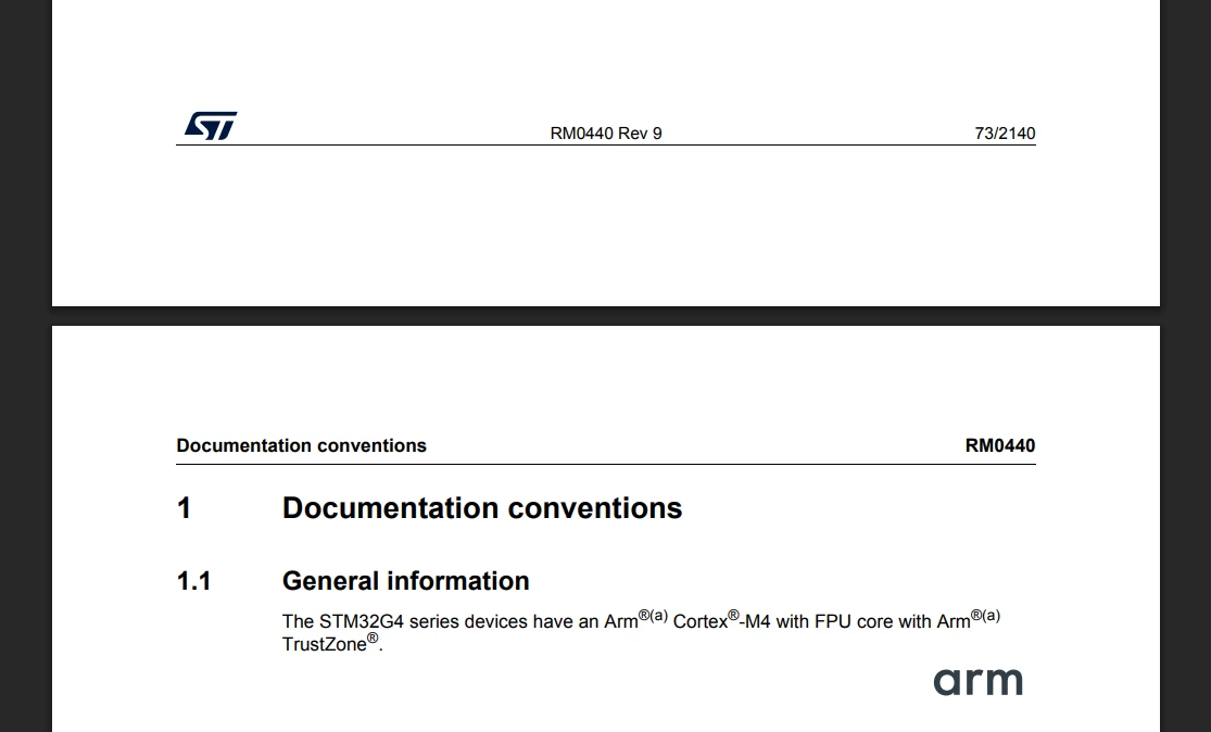

RM0440 Rev. 9 incorrectly states that STM32G4 has Arm TrustZone
Hello ST Community,
While studying the STM32G491RE at the bare-metal level, I noticed a statement in RM0440 Rev. 9 that looked inconsistent with the Cortex-M4 architecture and the STM32G4 documentation when i compared.
RM0440 - STM32G4 series advanced Arm-based 32-bit MCUs
Revision: Rev. 9
Section: 1.1 — General information
Page: 74
The document states: “The STM32G4 series devices have an Arm Cortex-M4 with FPU core with Arm TrustZone.”
However, the STM32G491RE uses a Cortex-M4 with FPU, which implements the Armv7E-M architecture. And Arm TrustZone-M is part of the Armv8-M Security Extension.
Could ST please confirm whether the above statement in RM0440 Rev. 9 is incorrect?
Thank you.

Hello ​@i_asta ,
Thank you for bringing that to our attention.
I’ll escalate it internally for analysis and eventual fix. Internal ticket for follow-up: CDM0066148 (not accessible by the community users.

The typo will be fixed and “TrustZone” wording will be removed from the section 1.1 in one of the coming revisions of the document.
Thank you again for your contribution.
