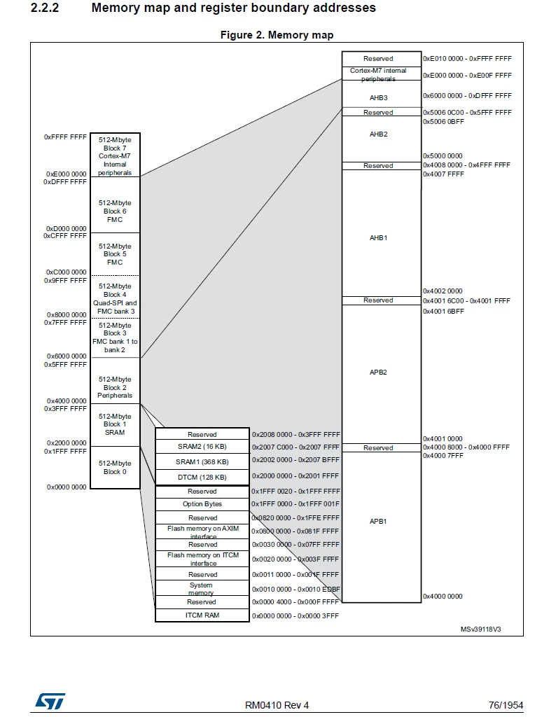

The memory map shown on page 76 of the reference manual for the stm32f76xxx shows the following figure:

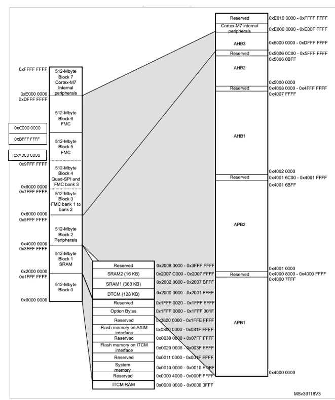

I believe the addresses in blocks 5...6 are not correct and that it should be as follows:

Hello @nick_berg
Thank you for reporting this. I confirm that it is a typo and I've reported to the concerned team for correction on the coming releases (under internal ticket number 183365).
Best Regards.
