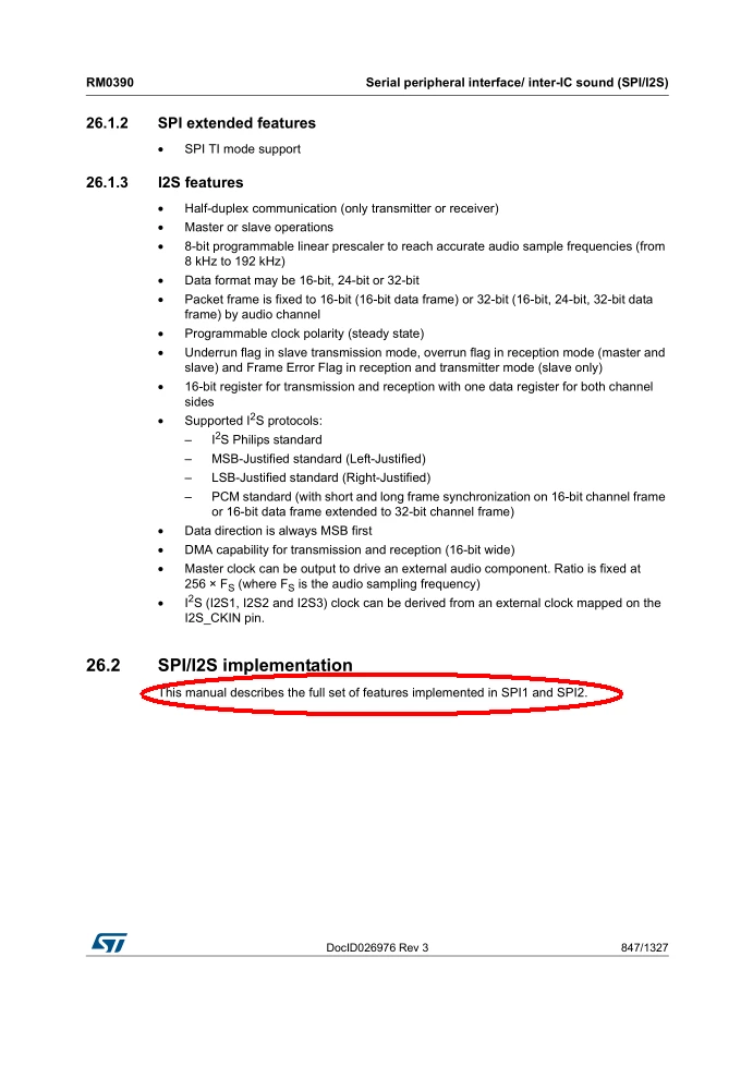

RM0390 STM32F446 SPI/I2S ''implementation'' subchapter
Posted on September 13, 2017 at 12:30
The 'F446 according to DS has SPI1 to SPI4, and SPI4 does not implement the full set of features (I2S missing).

    Posted on September 13, 2017 at 15:35
    Thank you
    Waclawek.Jan
    foryour feedback. I confirm this missing andraised it internally.
