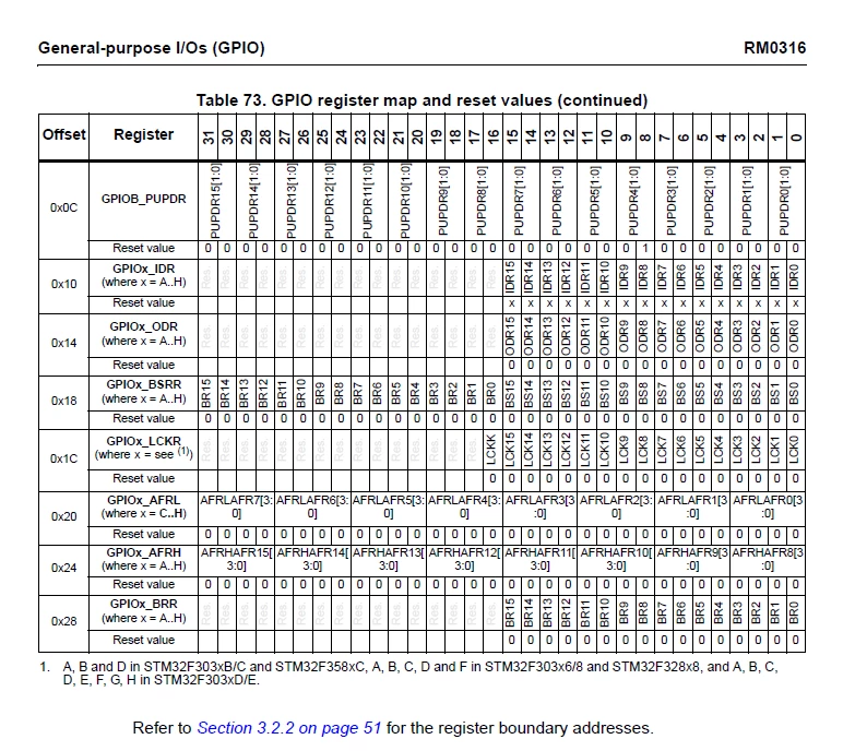

In RM0366 Reference Manual GPIO section it says that there is a BRR register at offset 0x28 but in the GPIO register map its not shown. I assume this is a mistake but I want to know if STM32F301C8 has a BRR register.

We confirm GPIO_BRR is available on STM32F3.
It is missing in the table 21 of RM0366.
It will be fixed in one of the the coming revisions of the reference manual.

looks confused to me as well. It seems there are something missing at GPIO register map...

While this looks confusing - have you checked the table does not continue on the next page ?
It is for instance in RM0316 (F303/328/358/398), but the top half there has no table title & link.
Assuming the F301 and F303 share the GPIO peripheral implementation, I suspect it is missing in the RM0366 table.

I need to check internally for F3 knowing that STM32F4 doesn’t have that BRR register.
Internal ticket number: CDM0065362.
I’ll get back to you as soon as I have the information.

I’m pretty sure F3 in general do :
And I actively used it in a few F303 projects.
The question is, is RM0366 inconsistent ?

Let’s wait for the internal confirmation.
