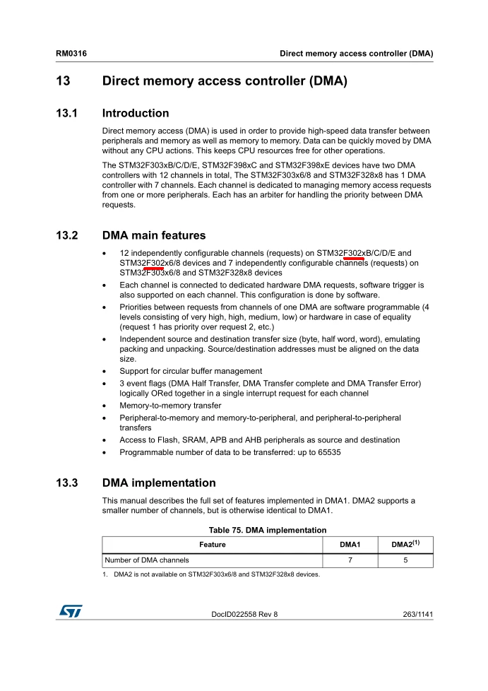

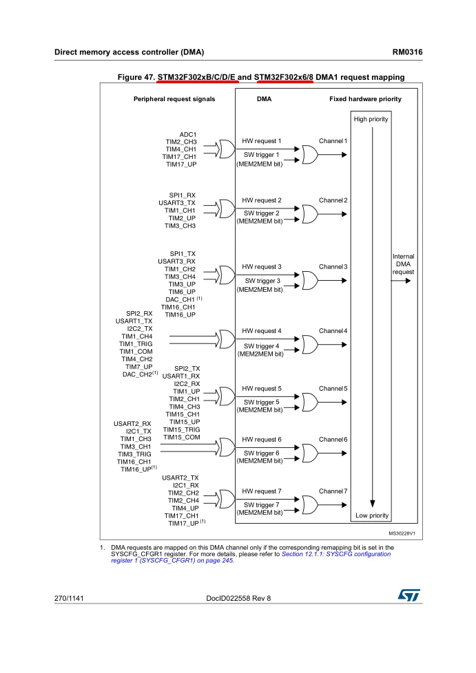

RM0316 (i.e. 'F303) - 'F302 relics
In the ancient times, RM0316 used to contain also 'F302, but that changed long ago. Yet some relics remained, causing confusion:
and a couple of more, related to these two, easily found by textual search.

Hello @Community member​ ,
Thank you for reporting this typo.
This typo will be fixed.
"Internal ticket number: 149714 (This is an internal tracking number and is not accessible or usable by customers)."
