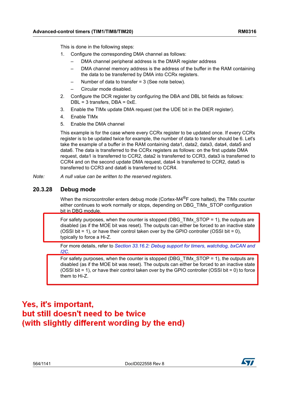

RM0316 and RM0394 duplicate text for TIM1 Debug
0693W00000aHK8NQAW.pngGiven the surprising combination of these two RMs, I'm quite willing to bet there are more RMs out there with this.
Nonfatal, but still.

Hi @Community member​ ,
This typo will be fixed in the coming RMs versions.
Thank you.
Thank you for reporting this typo.
I will check internally.
