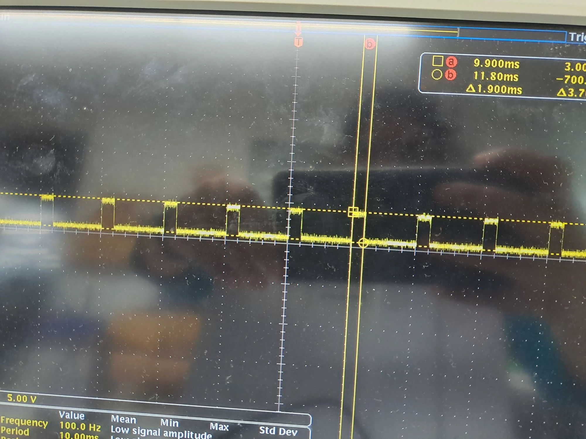

I am working with STM32G491RE.I am giving pulse to GPIO pin from function generator. That pulse will be 2 msec on time and 8msec off time.I need to make flag high if the signal from function generator lost.
Can anyone suggest me how to do this?

 I tried with EXTI interrupt but If input is there from generator its detecting both rising and falling edge and if there is no signal from generator I am not getting  in to else condition.
img: pulse input from function generator.
1.If I want to make flag high for no signal from function generator,above image offtime also it considering as no signal.
can anyone suggest how to do?
Thanks

Read HAL_GetTick within your interrupt and store as a global variable. To check if signal is lost see if difference from current HAL_GetTick and the one you stored is >10ms. If so, signal has been lost.

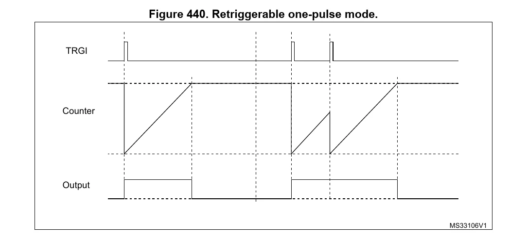

you could do it with a retriggerable monoflop , set to 10ms ; this would change output, if 10ms no trigger coming.
on a cpu this could be a timer ( ie. Tim 2..4) , set to Retriggerable one pulse mode , update interrupt (enable : UIE ) will trigger, when full time of timer is reached (if set to 10ms , get int then).

the trigger in is a gpio pin...just look in Cube , when you select ETR (external trigger)
you just cannot use any pin you like , every timer has some fixed pin numbers for this function.
