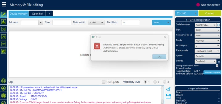

I thought aswell that NRST is not needed for SWD but when connecting with the CubeProg in Normal or HotPlug mode I get the same behaviour.

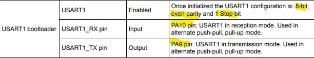

I already tried setting the BOOT0 pin on the STM32G0C1E-EV to Vcc by connecting CN9 pin 8 and 6. As far as I understand, I cannot set the option bites while not connected with the CubeProg or without HAL functions over Zephyr.
 I have already had a look at the AN2606 but couldn't see what connection over the ST-Link is easily accessed.
(Connecting UART over the VCOM for example leads to nothing)
At the same time when connecting to the UART1 bootloader with a Analog Discovery I also don't see any output.

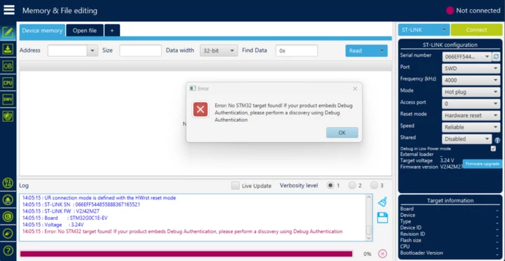

+ set st-link connection : reset mode -> software reset

Same behaviour with Normal and HotPlug mode.
Log:
08:55:04 : UR connection mode is defined with the HWrst reset mode
08:55:05 : ST-LINK SN : 066EFF544855888367165521
08:55:05 : ST-LINK FW : V2J42M27
08:55:05 : Board : STM32G0C1E-EV
08:55:05 : Voltage : 3.24V
08:55:05 : Error: No STM32 target found! If your product embeds Debug Authentication, please perform a discovery using Debug Authentication
In the log it displays HWrst reset mode even though the Prog reset mode is set to software reset.
Thanky ou for your time.
