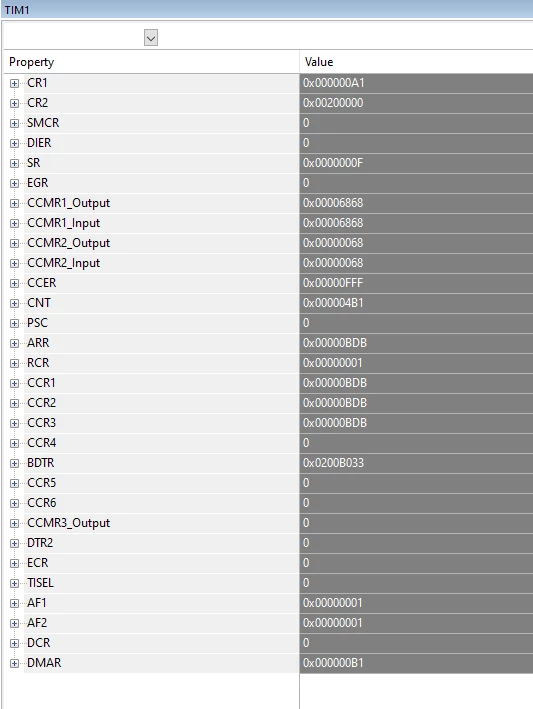

I'm using an STM32G431 using differential outputs on channel 1. On the scope, my deadtime is set where the channels overlap instead of having deadtime:
channel1
___-------___
------__-------
 channel1_n
How can I reverse the direction of the deadtime?
Here is my PWM setup:

Did you measure those waveforms directly at the mcu pins?
Read out and check/post the timer registers' content.
eRuss.1
eRuss.1Author
September 17, 2021
Here are the timer registers:
I have managed to change the symptoms by switching the polarity of:
sConfigOC.OCPolarity = TIM_OCPOLARITY_LOW;
sConfigOC.OCNPolarity = TIM_OCNPOLARITY_LOW;
This does not fully solve my issue though, because in this case, the PWMs have reverse polarity.
waclawek.jan
September 17, 2021
I don't quite know what do you mean by this, but try using PWM2 mode instead of PWM1.
eRuss.1
eRuss.1AuthorBest answer
September 24, 2021
This works great! Switching both OCPolarity, OCNPolarity and TIM_OCMODE_PWM1 did what I needed. Thank you!
