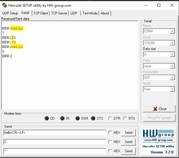

I modificate this function:
void UART5_IRQHandler(void)
if (LL_USART_IsActiveFlag_RTO(UART5)) //check RTO uart
LL_USART_ClearFlag_RTO(UART5); //delete flag
receive_char=DMA_RX_BUFF_SIZE-LL_DMA_GetDataLength(DMA1, LL_DMA_STREAM_0);
itoa(
receive_char
, buffer, 10);
usart_puts(buffer);
usart_puts(''\r\nNEW:'');
LL_DMA_DisableStream(DMA1, LL_DMA_STREAM_0);
LL_DMA_SetDataLength(DMA1, LL_DMA_STREAM_0, sizeof(dma_rx_buff));
LL_DMA_SetMemoryAddress(DMA1, LL_DMA_STREAM_0, (uint32_t)dma_rx_buff);
LL_DMA_EnableStream(DMA1, LL_DMA_STREAM_0);
And when I send first string, MCU return good value (7), but after this it is return only 0. And it is wrong value. Any idea, what is wrong?
Yellow: data from PC
Black: data from MCU
waclawek.jan
January 30, 2018
Posted on January 30, 2018 at 13:11
Read out and check/post the content of relevant DMA registers (including status) at the beginning of ISR.
Pilous Droip
Senior
January 30, 2018
Posted on January 30, 2018 at 13:12
Sorry, but I don't understand. How do you think?
