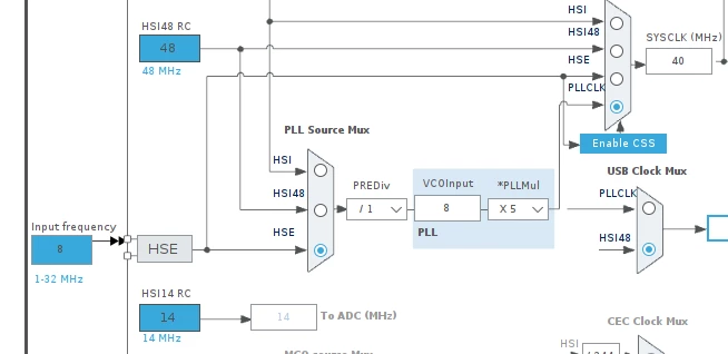

i would try : setting the pll in to 8 MHz (i have it here on F072 ), no problem on > 100 boards.
0693W00000YA0eRQAT.png+ your VDDA is clean , with caps close to chip?
