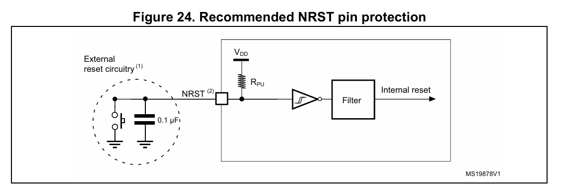

Hello team,
Generally , Reset pin by default status is Logic High.
But in AN4206 ( Page 31) , NRST pin is not Connected to 3.3V , it is left Floating with Capacitor.
Is that Okay ?
My device is STM32F303.
Regards,

Yes, the typical connection is floating with 0.1 uF cap. It is internally pulled up.

Would it Enable By Default or any Configuration Needed ?
Would it be Good Idea to pull-up NRST pin Externally as well ?
Regards,
Aug 6, 2025 1:33 PM UTC
No configuration needed.
Pulling it high externally does not add any functionality. It is unnecessary.

Hi Henrik,
One concern with ext.pull up is , it may paralle with internal pull-up to reduce resistance.  In my case , ext pull up will be 10k. We want to keep Reset function for USB DFU Bootloader.

The extra pull-up may be superfluous, but as the ball is already drawn out for the cap another resistor will not bother me. Later, the bean-counting army can get a bonus for removing it from the BOM.
BTW, our work-in-progress design (G4) omits the reset line from the SWD connector.
I have not found any situation that kills the connection yet but a TP may save the day some day.
Without full control over the supply I'd be more conservative though.
