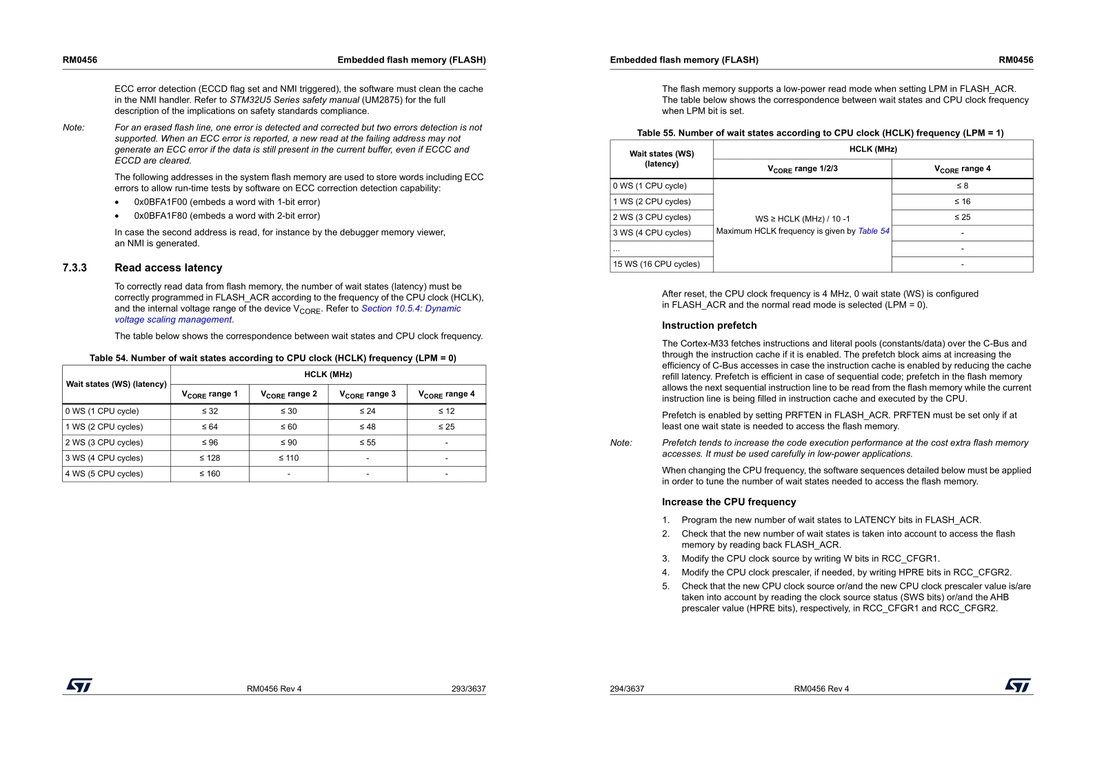

required flash wait states for stm32u575
Where does one find documentation on the required flash wait states for stm32u575 running at a specific frequency and voltage range?
In these forums and on the internet I find a number of tables but they all seem to be for other products.  I've search all the documentation I can find in the ST doc site for this chip:
  • data sheets
  • reference manual
  • programmers manual
  • application notes
  • errata
I find all the information I need to set the wait states, but I find nothing that tells me how to calculate the proper value to set based on speedand voltage range.
Any help would be appreciated
Shawn

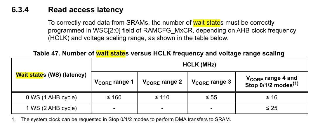

Aug 10, 2024 5:21 PM UTC
It's in the reference manual. It's 0 for the vast majority of cases.
rm0456-stm32u5-series-armbased-32bit-mcus-stmicroelectronics.pdf
waclawek.jan
waclawek.janBest answer
Aug 10, 2024 6:45 PM UTC
@TDK,
that's for RAM.
Here's the FLASH waitstates table(s):
