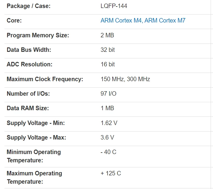

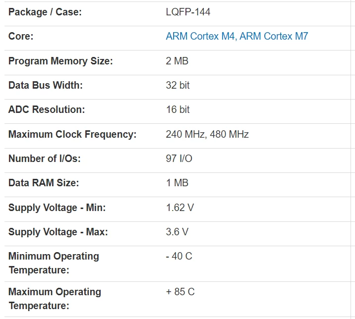

Thanks for the information. I am specifically looking at the LQFP144 configuration. I noticed that both the STM32H745ZIT3 and STM32H745ZIT6 microcontrollers are available on Mouser.com. However, I am confused about the differences between the two. What do the suffixes ZIT3 and ZIT6 mean?
Additionally, I saw on Mouser.com that the ZIT3 supports a temperature range up to 125°C, while the ZIT6 supports up to 85°C. This seems contradictory to what I expected. Could you clarify the correct temperature ranges for these models?
Lastly, both processors are listed as having Cortex-M4 and Cortex-M7 cores. Is this information accurate?
ZIT3:
ZIT6:

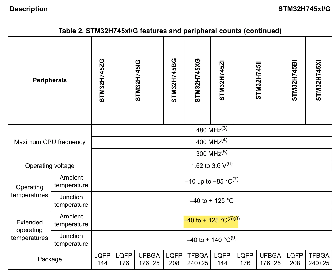

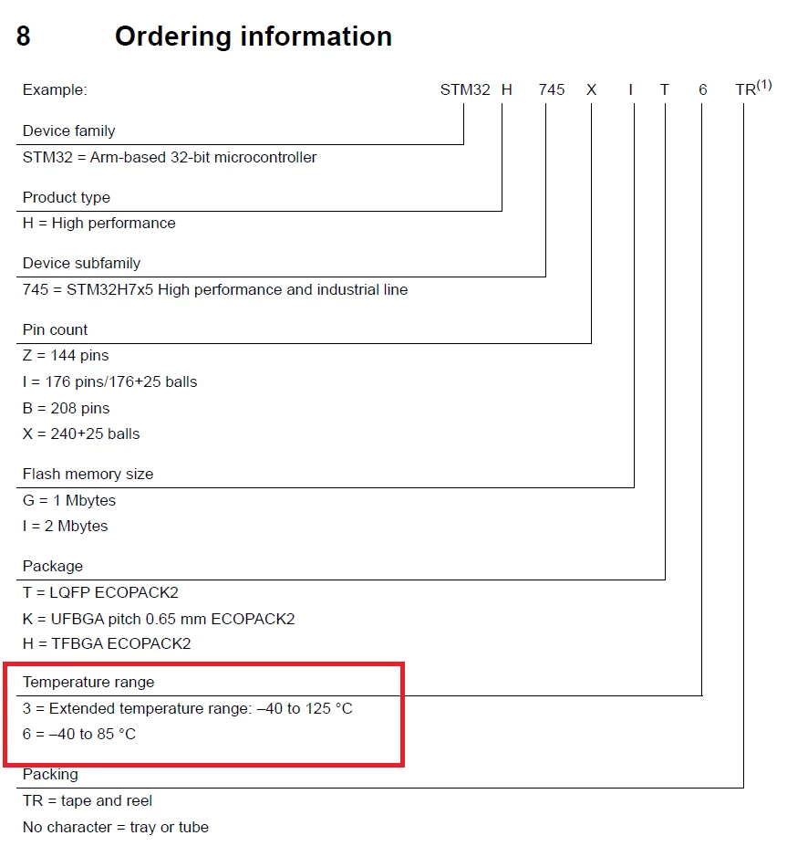

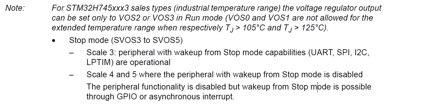

First I think the original question has been answered.
For your last question, you need to refer to the datasheet:
In summary:
3 is the industrial line and you can reach 125°C without exceeding 300MHz @VOS2.
6 is the "regular temp range" and you can't exceed 85°C but you can reach 480MHz @VOS0.
So it depends on your application and on which environment will be deployed.

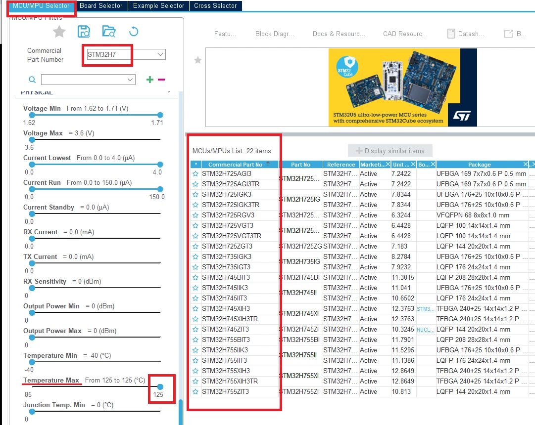

Can you provide the list of single core STM32H7 with higher temperature range >105 C. I couldn't find it in mouser.com. Thank you!
mƎALLEm
September 4, 2024
You can use CubeMx for that:
