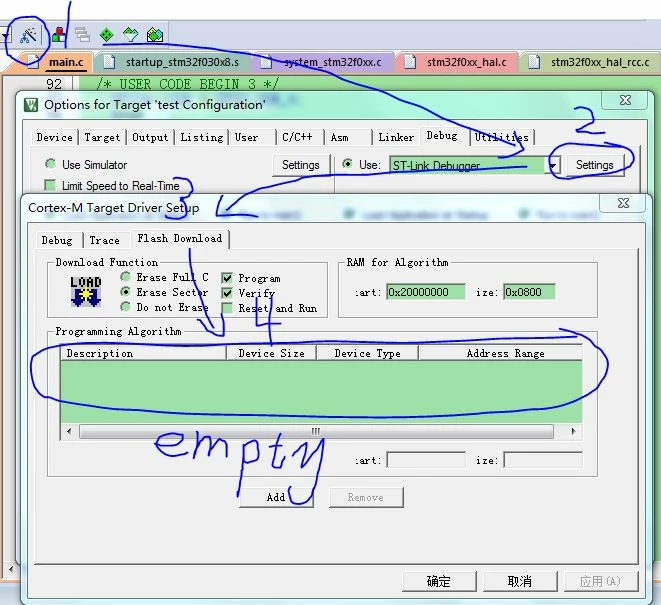

After I choose toolchain as MDK V4 in CubeMX and generate the code,the option of ‘Programming Algorithm' in KEIL is empty. When I set it, the next code generation will erase this again.

    Could you please share a screenshot explaining the issue?

    Here is the screenshot for issuse N0.2. Actually as you can see, I simulate this bug in KEIL v5, because I have uninstalled KEIV v4.72 as a result of this bug.It is quite same as shown in KEIV v4.72.

    Dear user,
    Thank you for reporting these issues. They are solved in STM32CubeMX next release: 4.12.0.
