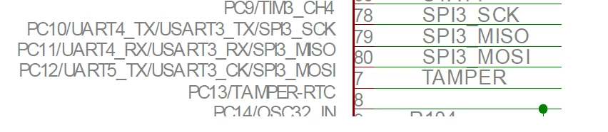

Hello everyone,
I am working with the STM32F107 chip on the STM32F107VC board from IAR.
The evaualtion board has an LCD which has as its inputs SPI3_MOSI and SPI3_SKC. But since it needs to have 9 bit inputs, i can communicate with the LCD either by manually
bit-banging or USART (which has a 9 bit output option).
But according to the datasheet, i can only remap USART3_SCK to SPI3_MOSI and USART3_TX to SPI3_SCK.
First of all, i can not understand, what the purpose of the above remap option can be. Is there a way, I can remap the TX of any USART to the SPI3_MOSI pin (and the Clock signals respectively)?
I hope to get an answer. If USART to SPI is not possible with STM32F107, I will do bit banging, not to loose any more time.

Your remapping choices are limited, you appear to have identified them correctly.
Seems odd IAR would have connected an LCD in a manner you couldn't communicate with it, have you looked over their demo code, or inquired further with them?
Not sure 9-bit synchronous USART is an ideal replacement for SPI
Can you not send 9x 8-bit bytes in place of 8x 9-bit values?

1- You confirm, that in deed if the mapping to the SPI3_MOSI (Pin 80) and SPI3_SCK (Pin 78), which is as following picture (this is from the IAR Board Schematic but the same is in the Datasheet of the STM32F107), does not allow mapping USART3 to them?
2- So from what I understand from your direct open question is that you advice me try to put maybe like 9 bits into the 16 Bit SPI-TDR (Transmit Buffer) and try out different configurations and see if maybe something works with the Epson Microcontroller (at least, there is nothing in your mind speaking obviously against it.). But then, I can not understand, in the Link I gave, this was not mentioned. Also in the example code of IAR, bit banging is used.

If the mapping of the USARTs to the SPI is as in the caps above, how can you use them? How can you use the USART_Tx on the SPI_SCK or the USART_SCK on the SPI_MOSI?
I fundamentally can not understand that.
Does not this configuration basically kills the option of using USART on SPI?

I don't think the USART is at all practical in your circumstances, in the other thread I don't think they were hog-tied to a specific board and wiring. It's usable in the ''general'' sense of getting 9-bits of clocked data out of the STM32's.
The placement of CS is also problematic with the USART, because nothing is going to do that automatically.
I suppose one might be able to DMA 32-bit values into GPIOC->BSRR and drive patterns onto the pins.
There are a number of weak design choices made in the peripherals in the part, for the sake of a fractional number of gates.
