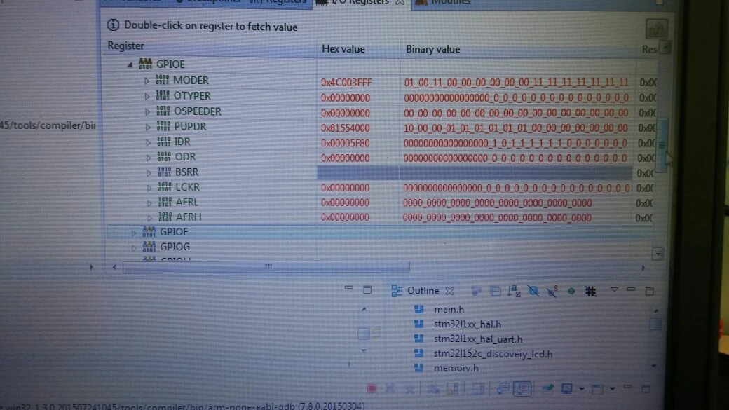

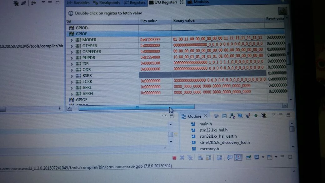

    -Just want to add on this point , the low power mode(stop mode) is enabled after 3mins of inactivity. Before going to low power mode (stop mode), all the pins are configured as analog input pins except one pin being configured as interrrupt to exit low power mode. On wakeup 6 pins are again reinitialized to input pullup
    How the voltage shifts?
    -Suddenly
    To which voltage?
    -varies between 1.23V to 0.82V
    If it is possible to run the debugger, stop the code when anomany occurs and inspect the GPIO register settings
    -Attaching the gpio register values for both working and non working conditions
    Working fine:
    Fault occured:
