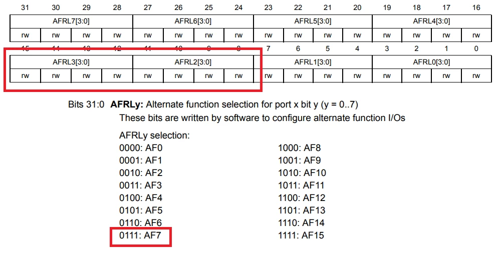

hi come across these code using register programing, STM32F411 Nucleo bd, anyone can advise how does the (AF07<<4) and (AF07<<8) relate to UART2 PA2 & PA3? please advise..
 #define AF07 0x07
 GPIOA->AFR[1]|=(AF07<<4)|(AF07<<8); //ALT7 for UART2 (PA2 and PA3)

This is writing AFR[1] so here describing settings for PA9 and PA10
10*4 - 32 = 8
9*4 - 32 = 4

 GPIOA->AFR[1]|=(0x07<<12)|(0x07<<8);
PA2 (UART2_TX) and PA3 (UART2_RX) correspond to shift left respectively 0x7 by 8 and 12:

Sorry, I do not understand how your objections regarding "blindly OR on values with zero bit(s)" applies for the code above.

April 8, 2024
