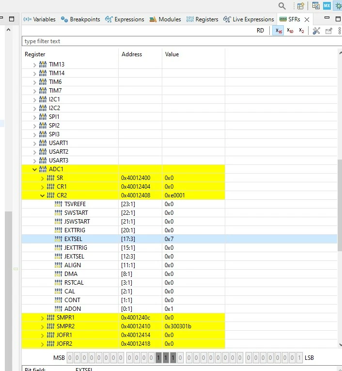

Next question: trying to setup the ADC for a simple read (single channel, polling - no interrupt yet). However, the conversion never seems to complete (or start?). Due to previous work, I am confident my clocks are set up correctly (printf is working, led blinking working, external interrupt (button) working).
Still using a NUCLEO-F103RB
I am setting up the ADC with the following code:
 * @brief Configure ADC GPIO pins: PA0, PA1, PA4

Unfortunately, even for arbitrarily large timeout values as an argument in the call to adc_pollForEndOfConv still result in timeouts (ADC failed message printing).
Am I missing something obvious here? I've read this code ten times at this point...

waclawek.jan
June 3, 2022
ADC in STM32 is very complex, and is perhaps the module which varies the most from STM32 family to other, so knowledge is not very transferrable and one has to meticulously follow guidelines in RM.
For example, I see this in RM0008 below description of ADON:
Note: If any other bit in this register apart from ADON is changed at the same time, then
conversion is not triggered. This is to prevent triggering an erroneous conversion.
Note, that debugging is intrusive, e.g. reading ADC_DR (using whatever means, including viewing it in debugger) clears EOC.

  1. Understood about the complexity of the ADC module. Good point about the note about other bits. However, I felt like I was not "changing" ADON there - I was only writing to it a second time. On p. 218 of RM0008, it states,
The ADC can be powered-on by setting the ADON bit in the ADC_CR2 register. When the
ADON bit is set for the first time, it wakes up the ADC from Power Down mode.
Conversion starts when ADON bit is set for a second time by software after ADC power-up
time (tSTAB).

The strange thing is when I try to debug, I never see the SWSTART bit get set in CR2, even with breakpoints at line 4 (above), or immediately afterward. Page 241 of RM0008 states, "This bit is set by software to start conversion and cleared by hardware as soon as conversion starts". I am not sure if I am not setting it properly or if it is getting cleared by hardware before I get to see it.

Still troubleshooting here, I tried to abandon the SWSTART as a trigger, and just used ADON:
void adc_start(void)
 ADC1->SR = 0; //Clear status register
// ADC1->CR2 |= ADC_CR2_SWSTART; //Does not work
// ADC1->CR2 |= ADC_CR2_SWSTART | ADC_CR2_ADON; //Does not work
 ADC1->CR2 |= ADC_CR2_ADON; //Works
I also removed the second write to ADON in the config function. Now getting successful conversions (EOC is being set as expected). So... it now works, but I do NOT know why it wasn't working before. I confirmed in the debugger that the EXTTRIG bits were set to all 1s (which per the RM, should be for SW triggers).
To recap: the latest code (included here) is successfully triggering conversions. When I try to do it with SWSTART instead, it does not. I cannot explain why.
