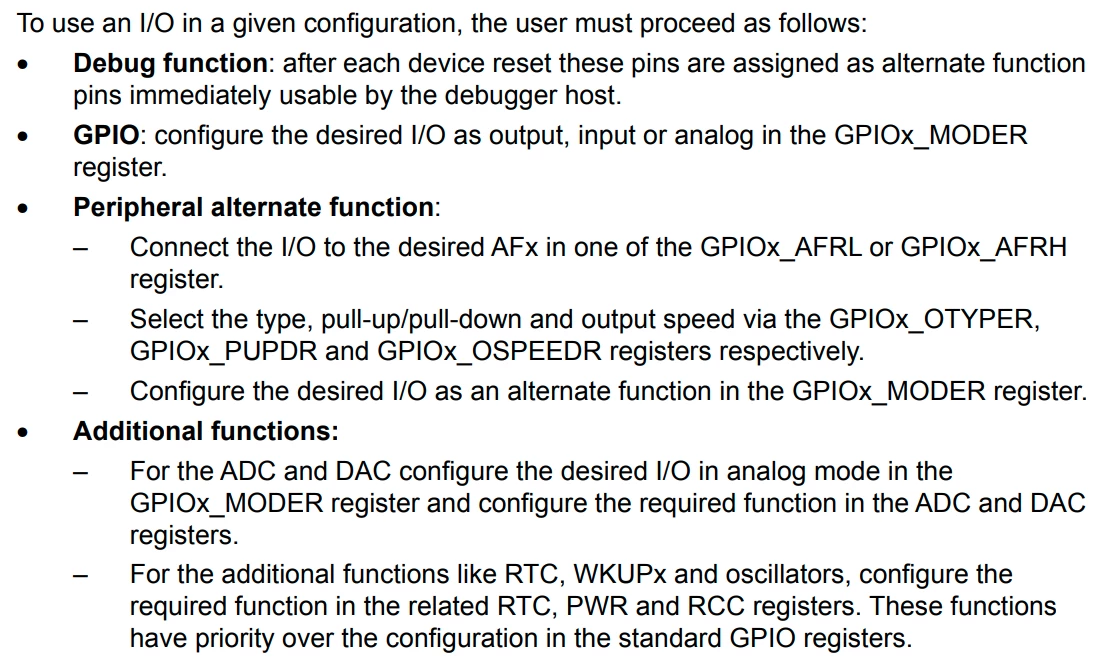

September 21, 2023
This section of the RM tells you how to configure pins for the desired mode:
There is also Table 114. Port bit configuration which has additional details.

What app are you using that generated the menu you have posted? Is that the reference manual?
The reference manual doesn't have a step by step process for GPIO initialisation because it is trivial.  You basically have to enable the clock, and set up the registers as specified in  the GPIO register section.  For more complicated peripherals the ref manual does give broad step by step procedures, but not detail other than the register description, but to see how its done in detail try using CubeMX to generate a project and look at the code.
That is how I learned.  The reference manual is not a coding manual, it's about hardware.  Have you access to a computer and a nucleo or discovery that you can set up to build a system?
