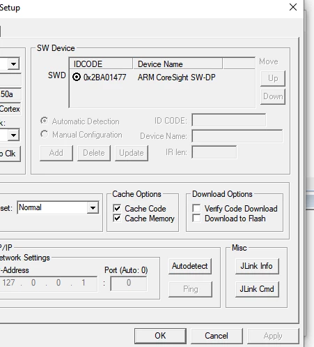

I am using STM32 board with on board debugger. I can build the code as well as Flash the code in Flash memory but not able to read the code from flash memory.
I want to unlock the STM32 with J-link. Please guide me.

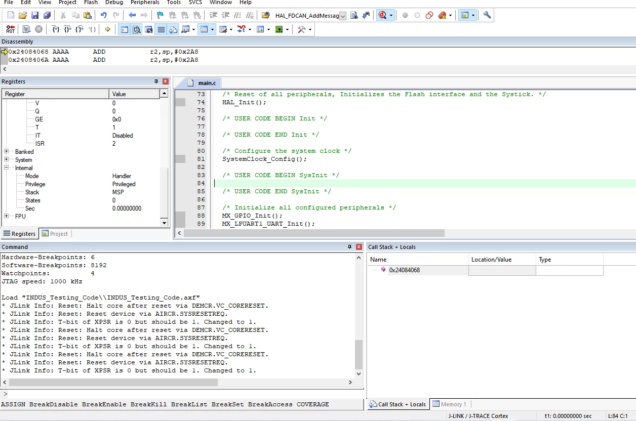

Please check the log messages in below attached image file(after flashing the code in flash memory).
I am not able to run the code in debug mode.
Apparently using the J-Link STM32 Unlock tool is hard to think of...

With the help of "J-Link STM32 Unlock" utility flash memory unlock issue get solved.
