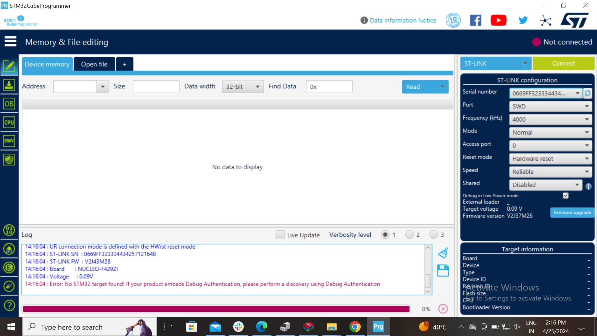

When i connect a USB ,it is showing like FAIL and a message is shown on the screen like
The interface firmware FAILED to reset/halt the target MCU.
Can any one let me know what is the reason for this and solution for this.

Try with CubeProgrammer , set mode "under reset" , reset "hardware reset" , connect ;
then show , what it tells (screenshot).

see:
So your board -> F429 cpu has no power.  Check jumper settings, see board manual.
Then connect again....
