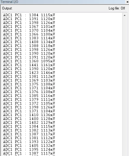

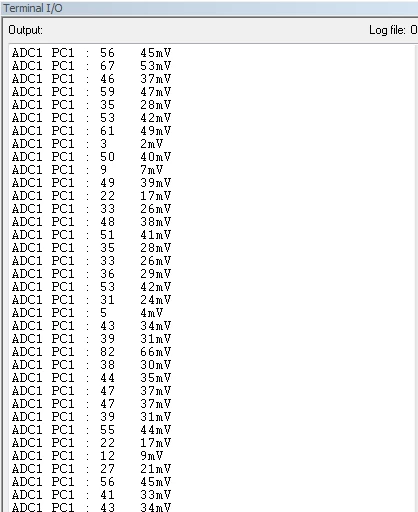

Dear All,
I'd like to test an ADC conversion using ADC example from STM32F3Discovery's peripheral examples.
I connected ADC1 channel(PC1) and GND to external power supply directly. and It was measured anormalvoltage between PC1 and GND using FLUKE Multimeter 8846A.
But, as attached the ADC value on Terminal I/O, theresults are very unstable. Is that due to the bad connection for ADC input source? or I cannot catch the problem exactly. Could you please help the issue?
1. supplying 0V to ADC1 channel(PC1)
2. supplying 1.0V to ADC1 channel(PC1)

    It could be induced noise from your multimeter. You can filter your signal adding a RC filter to the ADC input.

      /* ADC1 regular channel3 configuration */
      ADC_RegularChannelConfig(ADC1, ADC_Channel_7, 1, ADC_SampleTime_7Cycles5);
    I suggest to try a much longer sample time.
    Like ADC_SampleTime_181Cycles5 or ADC_SampleTime_601Cycles5.

    ... it is still unstable.
    How much ?
    The F3 discovery is not quite the best analog design, Vdda and Vref on the Disco is connected to Vdd (the digital supply), so you can't expect too much.
    Does the input impedance of your source match, and how long are the wires ?

    Kye-Hyun Park
    Nov 22, 2017 11:59 AM UTC
    Posted on November 22, 2017 at 11:59
    Thank you, ADC conversion result is stable after adding RC filter (1kohm, 0.1uF).
    FYI, The Cut-off frequency Fc is 1591.549430919Hz with R=1kohm, C=0.1uF from
    http://sim.okawa-denshi.jp/en/CRtool.php
    The problem has disappeared, but I wonder why high-frequency noise was induced to ADC input line.

    Your results may not be as bad as you think. With 0V applied the largest deviation is 45mV  or 1.5% of full scale(3V). Your voltmeter will read between 2% to 5% of full scale depending on make and model. This is very good performance for your design.
    The second set of reading show an offset of +0.1 or 10% of the applied test voltage this can be due to the source you are using ( power supply, voltage divider ...) . I will assume that you have verified the math to convert from ADC output  value  to mV.

    Your results may not be as bad as you think. With 0V applied the largest deviation is 45mV  or 1.5% of full scale(3V). .... This is very good performance for your design.
    I beg to disagree on this one.
    Shorting the ADC input as close as possible to the input should yield a zero result reading, give one LSB.
    A 45mV reading suggests noise, i.e. the sample cap picked up a substantial charge through long wiring and improper impedance.
