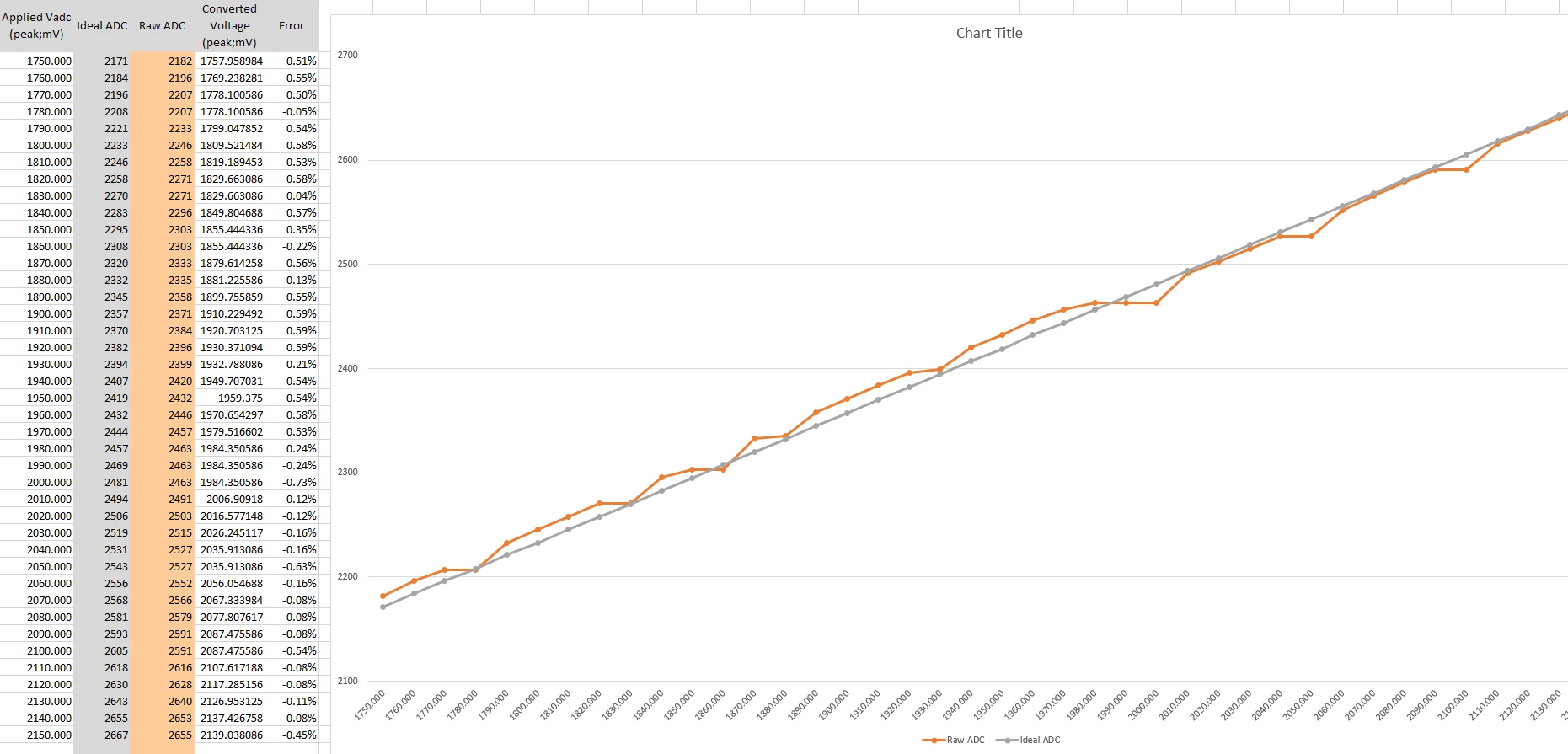

Dear all.
I measured ACD input increasing the voltage by 10mVdc. but, there are non-nonlinear points.

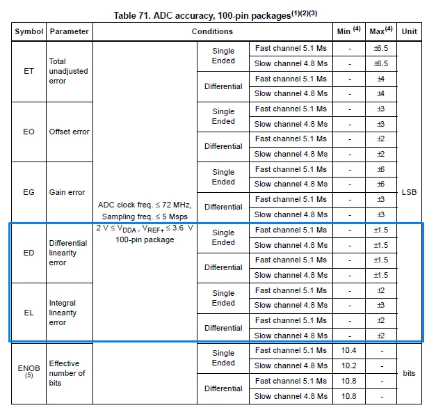

As the datasheet, ED and EL are +-1.5LSB and +_2LSB. It seems that my measurement result is bigger than them.
Could you please explain how to reduce the error?
Thank you in advance.
Vref : 3.3V
ADC clock : 72Mhz / 2 = 36Mhz
1 LSB : 3.3V / 4096 = 0.805664063
ADC channel : Fast channel ADC1 3channel
Sampling mode : Single-ended
Sampling time : ADC_SampleTime_7Cycles5
    4 replies

    Have you checked that your test conditions (electrical and software settings like sample time) match those stated in the datasheet you cited ?

    I think below my condition was satisfied with those test condition on the table.
    1. ADC clock freq : 36Mhz <= 72Mhz
    2. Sampling freq : 2.57Msps <= 5Msps
      • ADC clock = 36Mhz
      • Tconv = 7.5+12.5 = 20 ADC clock cycles
      • Sampling freq. = 20 / 36*10^6 = 555.55ns; 1.8Msps
    3. Vdda = Vref+ = 3.3V

    The PCB design / layout has a significant influence, as have the tolerence and impedance of your (reference) input voltage source.
    If you think some STM32 MCUs have a problem with the ADC peripheral, better discuss it with a ST FAE.
    Most people here, like me, are users, and need to rely on the same documentation as you.
    And the ST people present here are rarely hardware experts.
