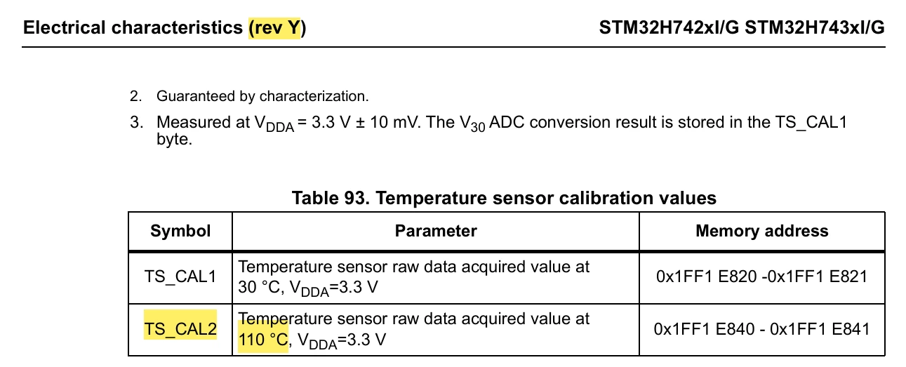

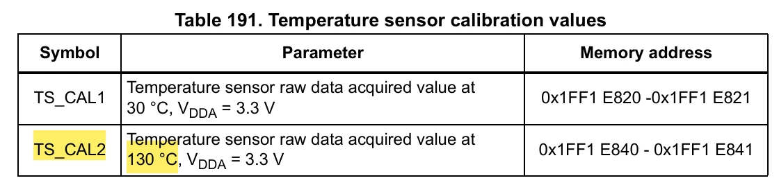

what is the maximum temperature did set in STM743 micro controller during factory set for TS_CAL2 Calibrated value? Is it 110*c or 130*C for maximum temperature Calibrated value ?
Since STM743 Production Datasheet Rev 7, Table 191 shows for 110*C but in Rev10 shows 130*c for TS_CAL2. The given memory address is same for both revisions so i will get only one data under that

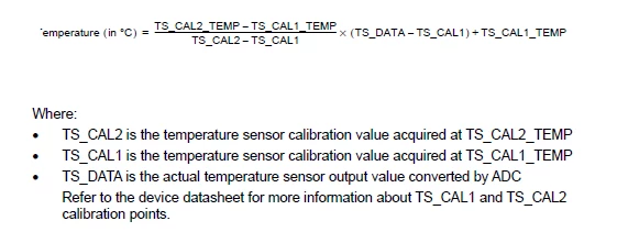

Rev7 STM743 Reference Document RM0433 in Section 25.4.33
Temperature (in °C) = 110 °C – 30 °C
-------------------------- × (TS_DATA – TS_CAL1) + 30 °C
TS_CAL2 - TS_CAL1
Rev8 STM743 Reference Document RM0433 in Section 25.4.33
Temperature (in °C) = TS_CAL2_TEMP – TS_CAL1_TEMP
------------------------------------------------------- × (TS_DATA – TS_CAL1) + 30 °C
TS_CAL2 - TS_CAL1
so I want to know that whether it is for 110*c or 130*c for max temperature Calibrated value.

Jan 8, 2025 3:20 PM UTC
The datasheet says it's 110 C for rev Y and 130 C for rev V. Presumably, the RM was changed due to it varying between revisions.

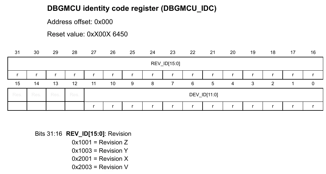

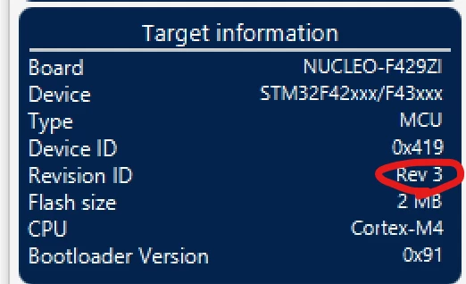

Jan 9, 2025 3:34 PM UTC
> So What is the max temperature did set in for the controller for TSCAL2 during calibration? 110* c or 130*c ?
As I said before:
To find out what chip revision you have, connect to it with STM32CubeProgrammer and look in the bottom right. Typically, you will have the newer revision (V).
SaranrajAuthor
Jan 9, 2025 7:17 PM UTC
Hi TDK,
 Thank You for your reply. How do i know the revision number if my system is closed and what if its production board ???

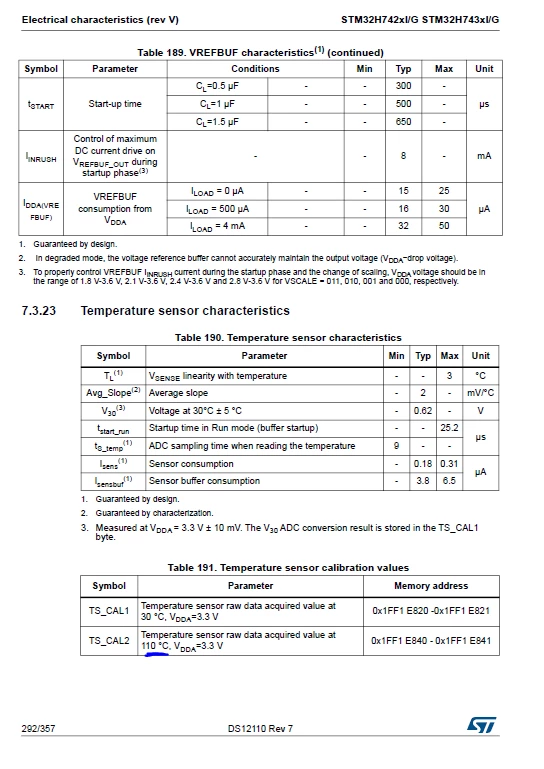

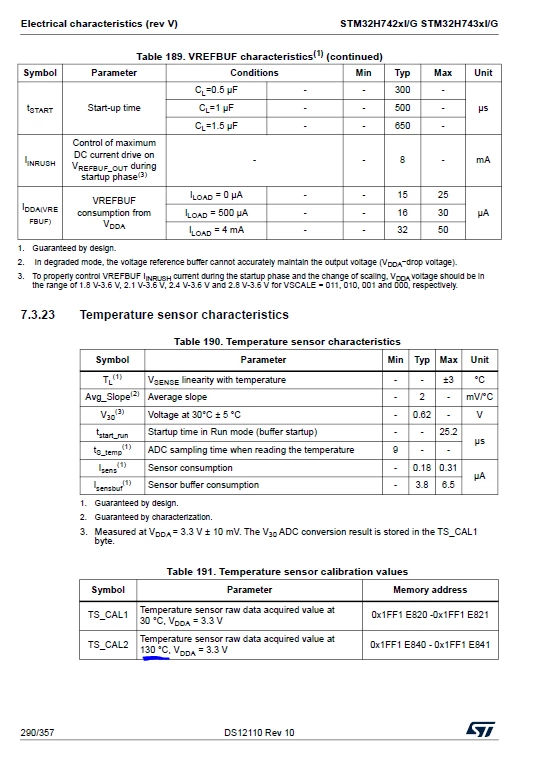

Jan 22, 2025 11:44 AM UTC
Hi TDK,
  I Got it. I agree with your points. I can map the value to 2.5V. But Both Rev 7 and Rev10 ST uC Datasheet shows different temperature in Rev V ?
In Rev 10
In Rev 7 DS
So While doing calculation which temperature should i consider for TSCAL2 when using below formula whether is it 110* or 130*C ? Please Calrify

Jan 24, 2025 9:59 PM UTC
> Please Calrify
Datasheets are revised to correct information. Use the latest one.
