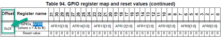

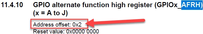

There's a small typo in the STM32H750VB reference manual (RM0433 Rev 8).
Page 545, GPIO alternate function high register (GPIOx_AFRH)
Address offset: 0x2 : Should be 0x24 (confirmed by the GPIO register map).
Have a nice day, thanks for the very extensive and useful documentation.

Dear @Briztal ,
Welcome in STM32 Community and happy to see you actively contributing.  Thank you again for the typo , we will escalate it to our colleagues for fixing .

Went to report this ST typo and see here that someone already has.
This AFRH offset address typo bit me as well, many wasted hours sunk into it, so wanted to renew it to the surface. Thought it wouldn't hurt to raise awareness again of the need, since it's been over 2.5 years since the most recent revision (RM0433 rev 8) came out. See below.

Dear @ElectronixOnyx  @Briztal ,
We are checking internally, and we confirm we have not yet a new Release of this Reference Manual since that time, in general we update in case of major changes. For Traceability we logged the ) with this number #215829.   Thank you for the understanding.
