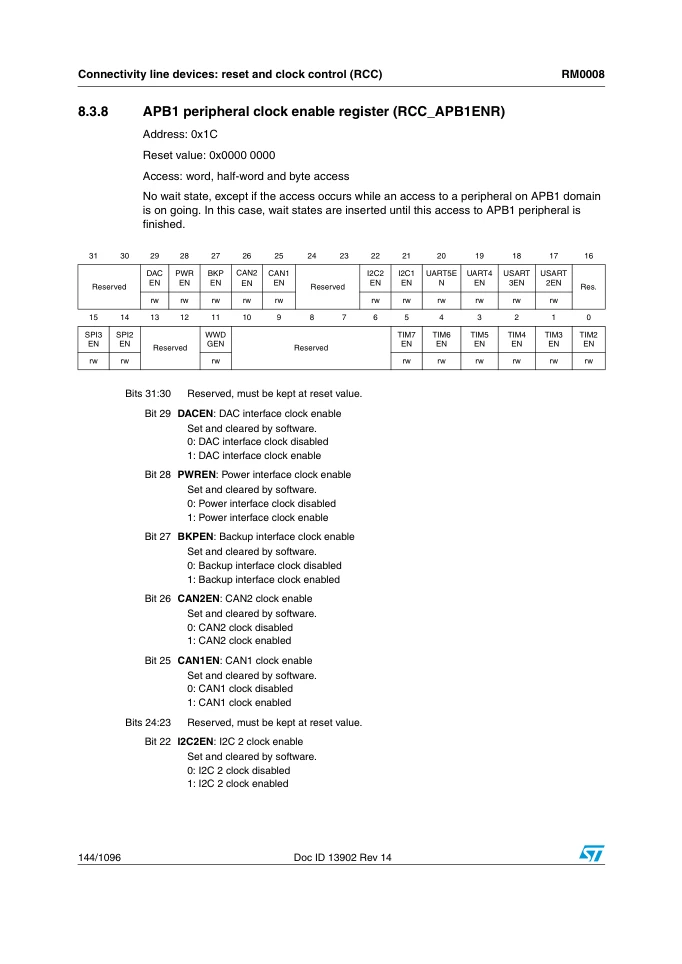

Reference manual RM0008 for STM32F107xx outdated or wrong?
The STM32F107Vx has 2 CAN interfaces.
In the TRM RM0008 Rev 21 dated February 2021 on page 115 I can only find one entry to enable the CAN clock, bit 25. What CAN clock does this bit enable? CAN1, CAN2 or both? Or does the reserved bit 26 enable CAN2 and bit 25 CAN1?
I could not find any additional information (documentation) answering these questions. Died I miss something?
regards, Felix

The 'F107 belongs to the Connectivity line, which has a separate RCC chapter.

Ooops, what a shame. I should have been more careful.
Many thanks for hint, Felix
