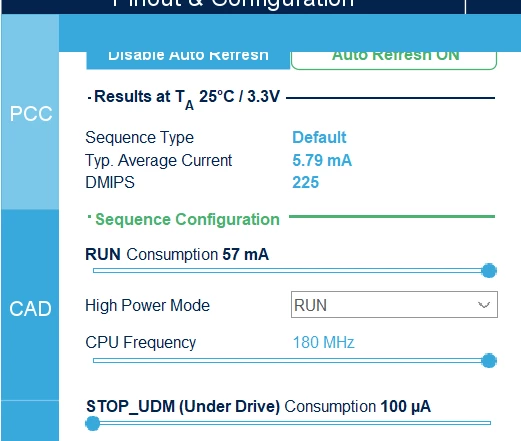

USB HS is used as MSC with external PHY is running ok. Want is to reduce power, by trying low-power code gets stuck and I need help on enabling same?

Could you provide more details on how the code gets stuck and which product is being used? Additionally, please specify your hardware architecture, as it must support detecting the presence of VBUS.
Depending on your STM32 product, the OTG clock might be enabled during sleep mode, but note that some restrictions may apply.
When the OTG_HS is in a USB suspended state, the application can significantly reduce overall power consumption by shutting down all clock sources in the system. You need to follow procedure described in corresponding reference manual. It is also essential to check external PHY registers to enable low power mode for proper operation.
Don't forget to set all free or unused pins to Analog mode. For more information, please check the provided link

Thanks for replying, the changing unused IOs to analog option got me into a issue, where by Im not able to re-program the controller F429 custom board, the debugger refuses to identify the controller, causing unable to change the program.
also I tried reducing cpu clock to 90 mhz
I tried checking swd lines and boot0 and boot1 lines, looked ok to me.
