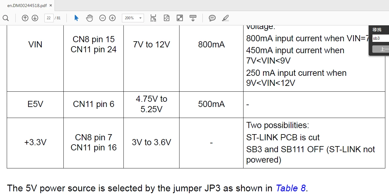

Hi all
According to en.DM00244518.pdf page 22
We could use +3.3V as power supply only in situation ''ST-LINK not powered''.
My question is when I use E5V, if I remove SB3 and SB111, the st-link part will not be powered. Right?
Thank you all in advance.

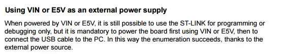

    Posted on April 05, 2017 at 19:25
    Hi
    paker.earth
    When use E5V, it's possible to use the ST-LINK for programming or debugging, as mentioned in theUM19
    Imen
