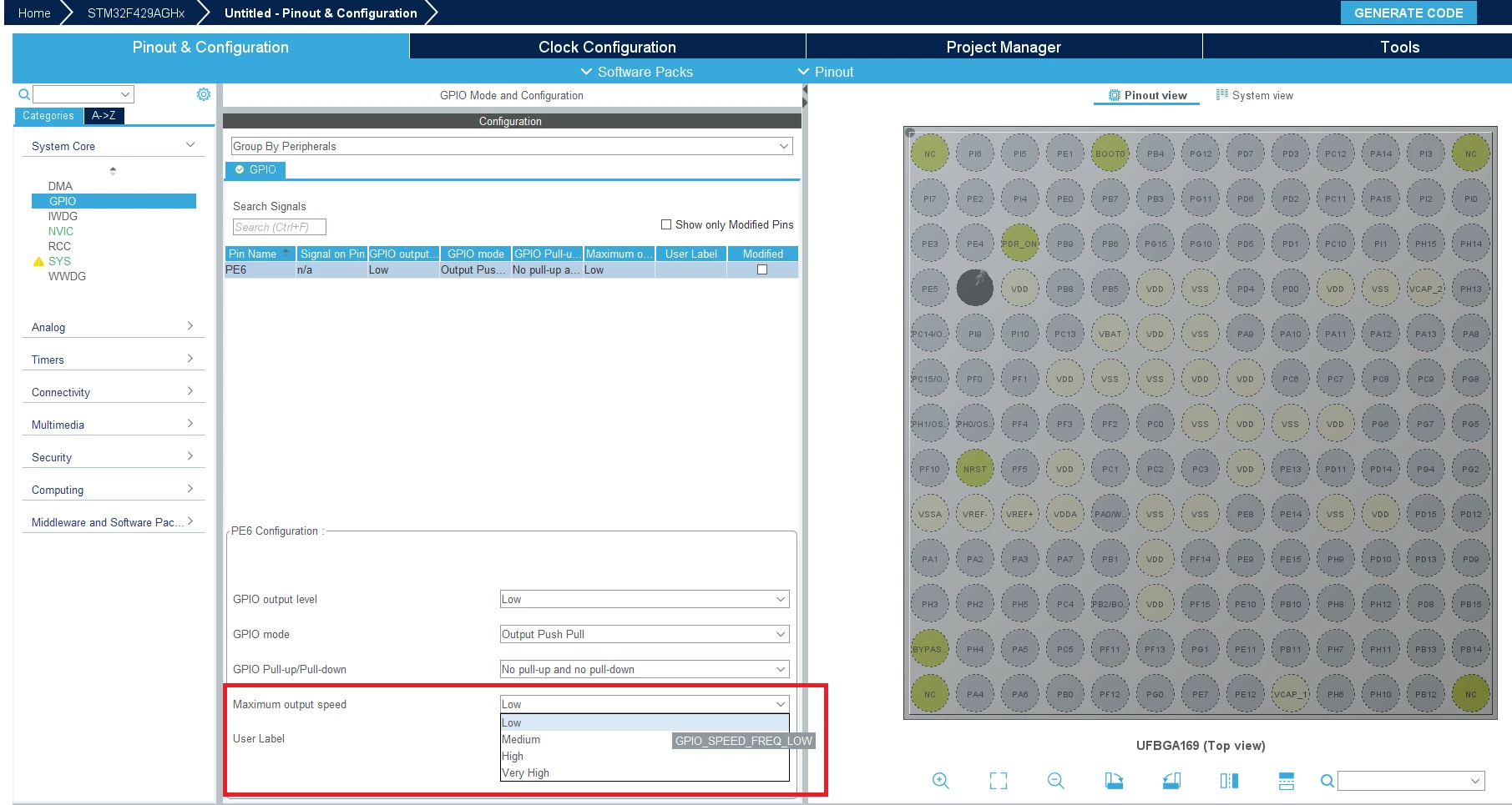

Can I know any available settings to reduce I/O speed. The idea is to reduce power consumption by F429.
CubeMX doesn't allow to change I/O speed.

Hello @GauravK ,
How?

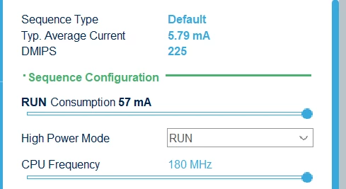

Hello, thanks for all replies. wanted to know then why cubeMX has below options, which lower consumption by reducing cpu freq

You are confusing IO speed with CPU speed. In fact, the current consumption of an MCU depends on the clock frequency, among other things.
However, the IO speed generally refers to the steepness of the edges when switching the IOs (rise time and fall time), which, as already mentioned, mainly has an influence on the interference radiation of the IO, but is almost negligible for the current consumption.

  2. There were comments that clock won't affect power consumption, so I found tool showing CPI clock changing power

It depends if the pin is changing state, it's a pin level attribute, worse case you can change in code. Image in SofLits image hard to read/zoom here.
