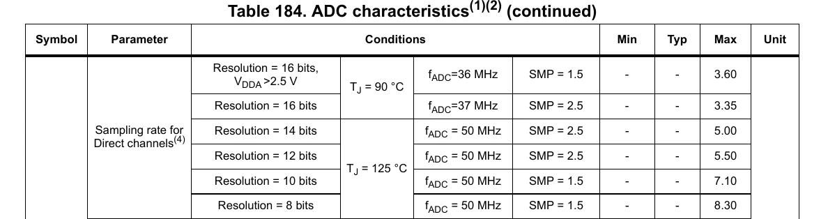

Recommend Microcontrollers with high speed sampling ADCs (20Msps)
需要具有内置采样速度 ADC 的 MCU 产品,约为 20Msps
Google Translate:
Need an MCU product with a built-in ADC sampling speed of about 20Msps
1 reply
AScha.3
March 28, 2025
There is no internal 20 Msps ADC.
ie H743 has 3 ADCs, each can :
maybe possible: use all 3 ADCs in interleaved mode, so possible 21 Msps at 10 bit .
But if you wanna make a DSO, need a FPGA and a flash ADC , maybe the famous series by Ti.
