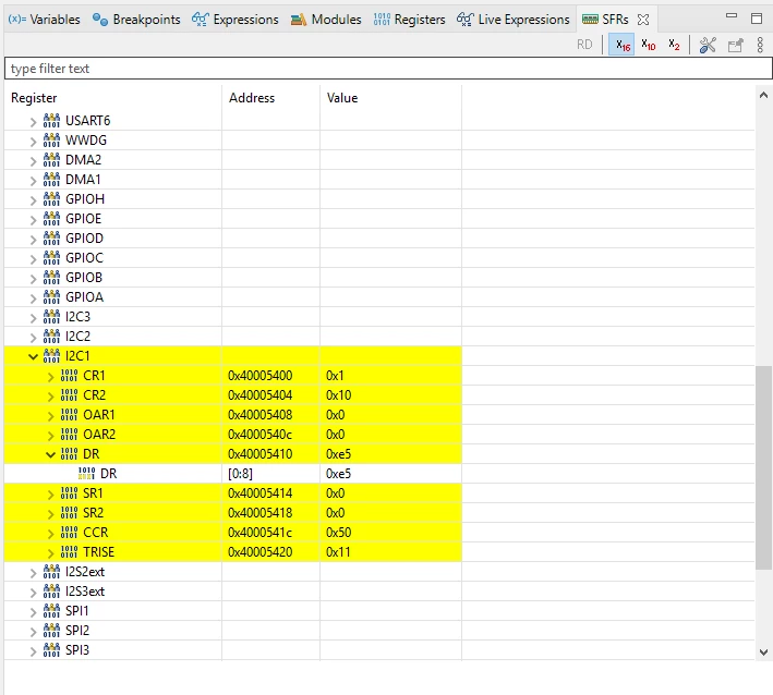

I have an STM32F411RE Nucleoboard and an ADXL345-M accelerometer. I have 2 problems.
  1. I want to read 1 byte data from the accelerometer. In this case I want to get he device id (0xe5) and store it in a variable. In debug mode it seems that the device id gets into the data register, but when I want to store it in a variable nothing happens.
  2. When I debug my code and if I stay a bit more time on a line where I'm waiting e.g. for the ADDR=1 (while(!(I2C1->SR1 & I2C_SR1_ADDR)) {}), after click to "Step Over" it seems that it get's into an endless loop.
I attach my code and a picture about register values.
Thank you in advance for your help!

> uint8_t id[0];
"id" is defined as array of length 0. Probably not going to be able to put anything in there. Technically array of constant length 0 aren't allowed, but GCC didn't throw any warnings for me on it with default settings.
I2C protocol requires you to react to certain events quickly enough such that single stepping in the debugger is likely to cause problems. I would suggest finding another method to debug, perhaps through a UART stream or ITM.
The value that you store in "id" is also never used anywhere, so the compiler is free to optimize that out.

Thank you for the answer!:folded_hands:
Indeed the 0 array length was the problem...This is the case when can't see the forest for the trees.=)
