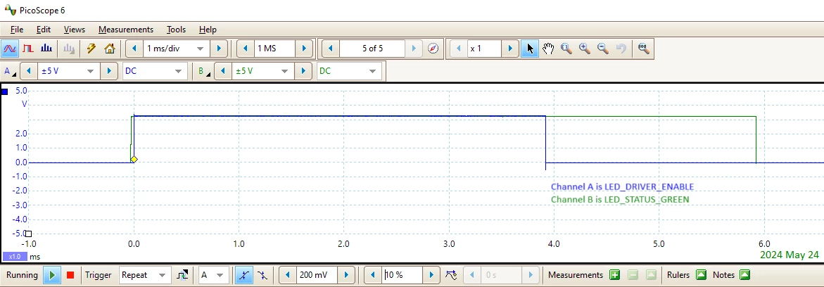

Colleagues,
Here’s a code snippet which changes the state of two GPIO lines with delays in between.
[My actual firmware has more code, and I’ve reduced it to this condensed example which still has the issue.]
HAL_GPIO_WritePin(LED_DRIVER_ENABLE_GPIO_Port, LED_DRIVER_ENABLE_Pin, GPIO_PIN_SET);
HAL_Delay(1);
HAL_GPIO_WritePin(LED_STATUS_GREEN_GPIO_Port, LED_STATUS_GREEN_Pin, GPIO_PIN_SET);
HAL_Delay(1);
HAL_GPIO_WritePin(LED_DRIVER_ENABLE_GPIO_Port, LED_DRIVER_ENABLE_Pin, GPIO_PIN_RESET);
HAL_Delay(1);
HAL_GPIO_WritePin(LED_STATUS_GREEN_GPIO_Port, LED_STATUS_GREEN_Pin, GPIO_PIN_RESET);
The resulting picture on the oscilloscope looks quite wrong.
oscilloscope screenshot of GPIO outputsoscilloscope screenshot of GPIO outputs
Legend for the oscilloscope plot:
Channel A is LED_DRIVER_ENABLE (PA3)
Channel B is LED_STATUS_GREEN (PB0)
The most troubling part is that the LED_STATUS_GREEN goes up before LED_DIVER_ENABLE on the oscilloscope.  In the code LED_DIVER_ENABLE precedes LED_STATUS_GREEN.  [It's more visible in my update below.]
In addition, the first call to HAL_Delay(1) produced a 0.1ms delay instead of expected 1ms.  The second and third calls to HAL_Delay(1) produced 4ms and 2ms delays.
What could be causing these issues?
Any suggestion, insight or reference is really appreciated!
STM32G474. I ran the code on two copies of the board, and the microcontrollers are from the same reel.  I see the same anomaly on both of them.
The compiler is CubeIDE v1.15.1 . The optimization is -O0 (no optimization, which is the default setting).  Let me know if I should provide more information.
Sincerely,
- Nick

Pavel A.
May 24, 2024
(you know of course that HAL_Delay(1) can take any time from 1 to 2 ms ? )

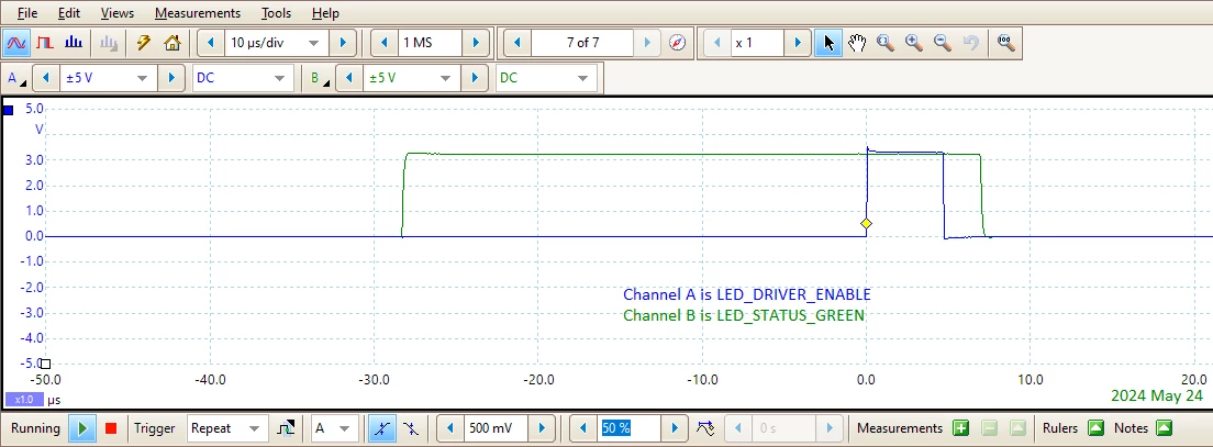

update:
Here's an even more condensed code for this issue.  I removed the delays, but the GPIO outputs are still out of order.
Channel A is LED_DRIVER_ENABLE (pin PA3)
Channel B is LED_STATUS_GREEN (pin PB0)
time axis in [microseconds]
edit:  Here's the disassembly.  I'll have to read-up before I can understand it.
222 HAL_GPIO_WritePin(LED_DRIVER_ENABLE_GPIO_Port, LED_DRIVER_ENABLE_Pin, GPIO_PIN_SET);
0800077c: movs r2, #1
0800077e: movs r1, #8
08000780: mov.w r0, #1207959552 @ 0x48000000
08000784: bl 0x8003828 <HAL_GPIO_WritePin>
226 HAL_GPIO_WritePin(LED_STATUS_GREEN_GPIO_Port, LED_STATUS_GREEN_Pin, GPIO_PIN_SET);
08000788: movs r2, #1
0800078a: movs r1, #1
0800078c: ldr r0, [pc, #328] @ (0x80008d8 <main+808>)
0800078e: bl 0x8003828 <HAL_GPIO_WritePin>
229 HAL_GPIO_WritePin(LED_DRIVER_ENABLE_GPIO_Port, LED_DRIVER_ENABLE_Pin, GPIO_PIN_RESET);
08000792: movs r2, #0
08000794: movs r1, #8
08000796: mov.w r0, #1207959552 @ 0x48000000
0800079a: bl 0x8003828 <HAL_GPIO_WritePin>
232 HAL_GPIO_WritePin(LED_STATUS_GREEN_GPIO_Port, LED_STATUS_GREEN_Pin, GPIO_PIN_RESET);
0800079e: movs r2, #0
080007a0: movs r1, #1
080007a2: ldr r0, [pc, #308] @ (0x80008d8 <main+808>)
080007a4: bl 0x8003828 <HAL_GPIO_WritePin>
Pavel A.
May 25, 2024
Does one of the GPIOs "gate" the other? So that one cannot raise until the other is in high state?
Bring more water.
waclawek.jan
May 26, 2024
As @Pavel A. said above, a minimum-1ms-time-wasting-delay with 1ms granularity can take 2ms, and it does, if it is invoked two times in a row.
My guess is that you set LED_STATUS_GREEN in the code you haven't shown us, before the snippet you've shown us.
Place a breakpoint - or infinite loop - just before that code and observe LED_STATUS_GREEN.
gbm
May 26, 2024
Make sure to set the scope to CHOP mode (not ALT).
