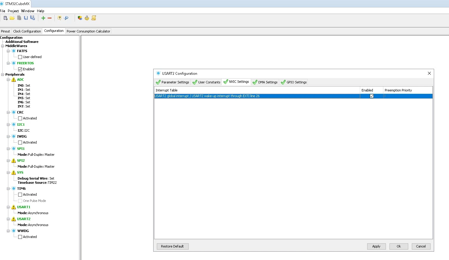

USART2 INT number # 26 instead of #
I'm building a new project that involve FreRTOS and USART2, when enabling the interruption for the USART2, (Configuration-> USART2 configuration->NVIC Settings) the application shows USART2 Global Interrupt / USART2 wake-up interrupt through EXTI line
i'm missing something here? the real int number for USART2 is not 28?
the code is generated with int number 28, reference manual andstm32l051xx.h point to .
here is about the environment:
STM32CubeMx 4.25, STM32Cube V1.0,Atollic TrueSTUDIO® for STM32, Built on Eclipse Neon.1a.,Version: 9.0.0,Build id: 20180117-1023

    for NVIC, value 28 is index where interrupt is served. Before that, there is EXTI part of STM32 and it is mapped to 26 in this block.
    Which MCU part number do you use?

    If interrupt ♯ 28 is the EXTI26 interrupt, which is presumably tied to the USART2's wakeup facility (i.e. USART_ISR.WUF), what's the interrupt number of the USART2, ie. the other USART_ISR flags?

    ♯ 28 is for USART. This one is also served via EXTI to allow MCU wakeup from low-power modes. Similar to RTC.
    RM0377, Table 53.

    Thanks for the info, i'm using an ST32L051C8T3..
