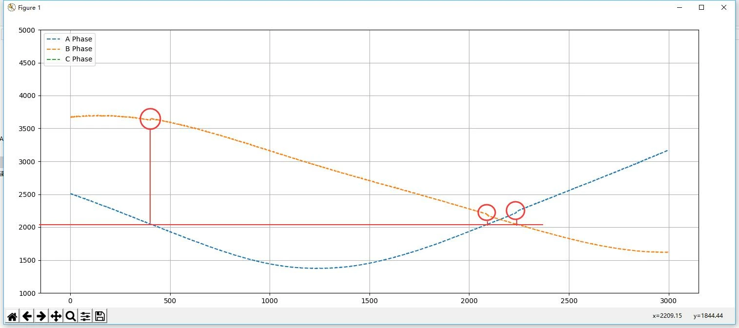

I'm using STM32F103CB to convert the analog outputs from three polar hall sensors arranged circularly, a magnetic actuator rotates in the center, but I get the voltage value with strange breakpoints, and these happened with a interesting phenomenon which happens with a phase at voltage value of 2048  and I can't explain why, maybe someone had faced this problem, please help and tell me how to solve this.
Problem phenomenon: the value from ADC channel will have a breakpoint when it or other ADC channels in ADC channel group at voltage 2048, here are the screenprint with brief:

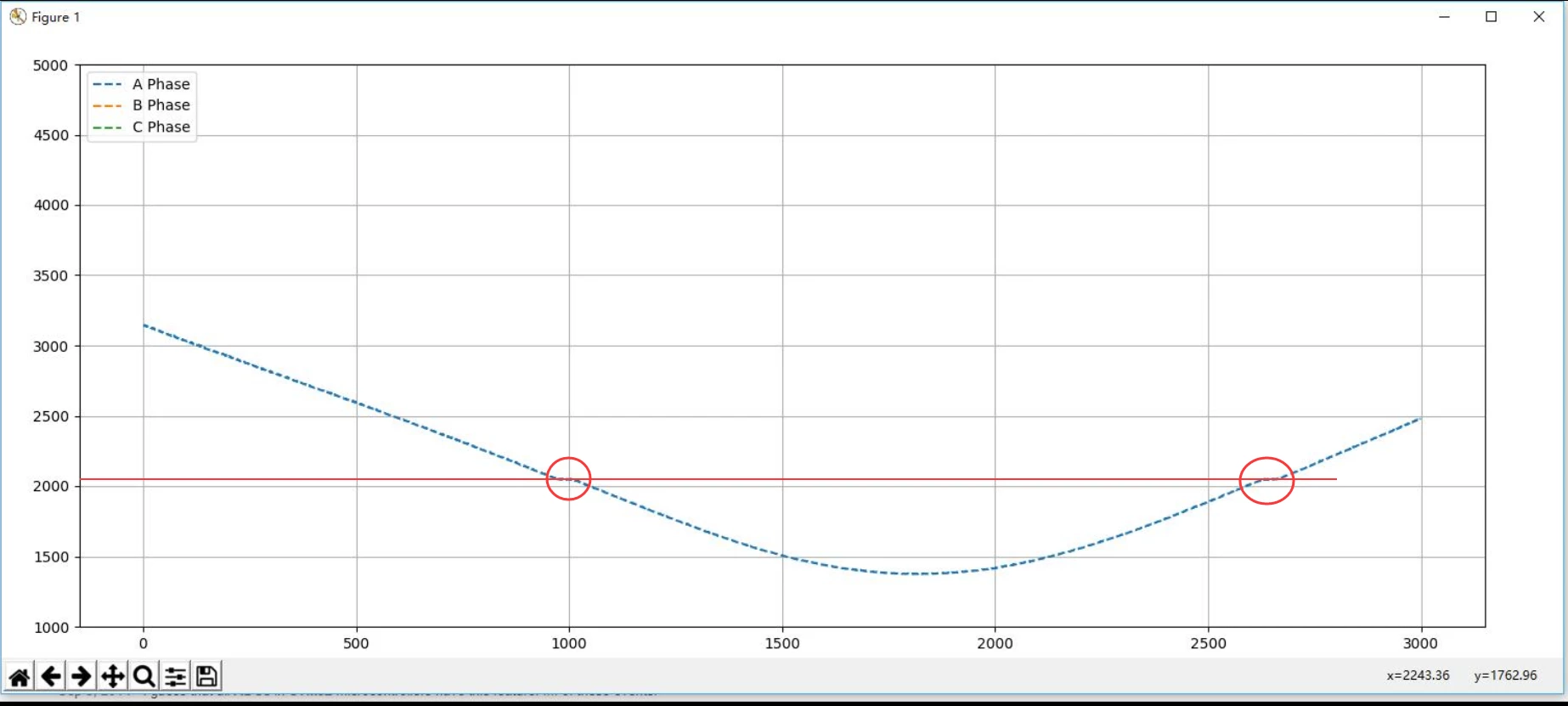

  1. Single channel reading:

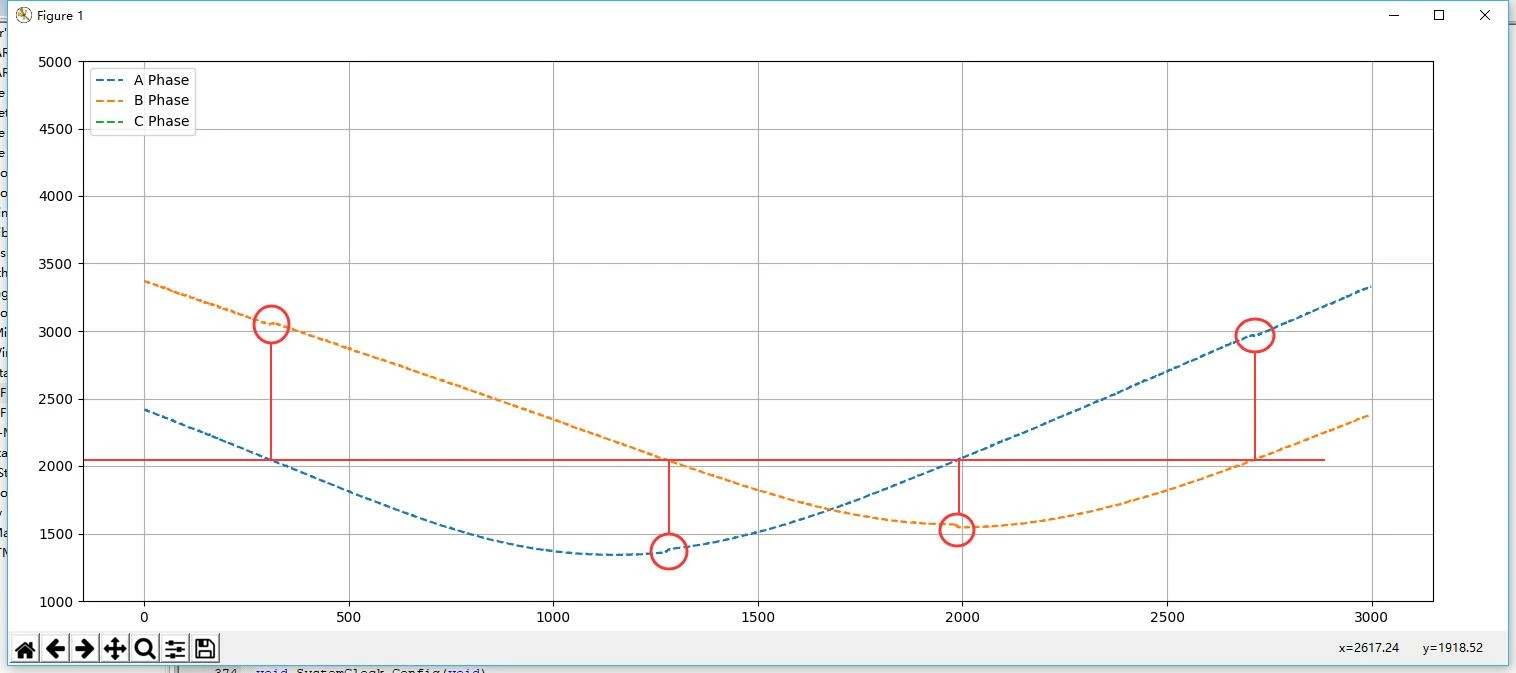

  2. Tow phases with 60
    � space?
  3. Tow phases with 120

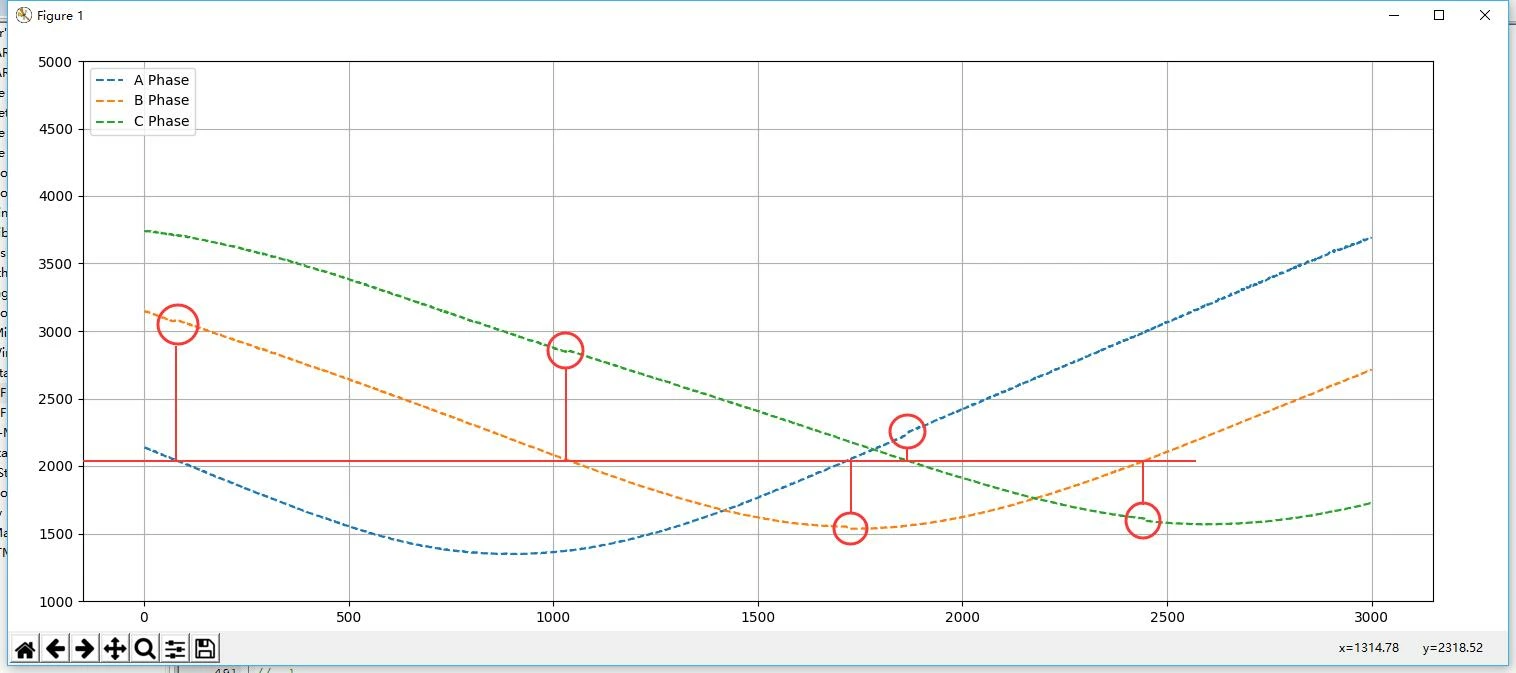

  4. Three phases with 60
    � space:

do you have long enough sampling time for ADC inputs, according to source impedance? Further please avoid capacitors at ADC inputs.

Thank you, I checked my configuration after read your reply, the impedance of the source was higher than the calculated max impedance base on my sampling time setting, longer the sampling time solves the problem temporarily, I will reduce the impedance of source in next step.
I don't get why avoid capacitors at ADC inputs? I have placed 2nF capacitors near each the ADC pin for low-pass filter

Because internal sampling capacitor is part of the ADC structure and gets charged to Vref+/2. During sampling phase, the charge may influence your low-pass capacitor voltage, and if it is not restored by low impedance source during conversion time, the voltage may travel.
