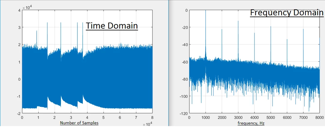

Hello, it is the first time when i have to deal with microphones and PDM interface. I just can't get correct data from the microphone, or the data is correct but i am doing something terribly wrong. I configure I2S to sample microphone with DMA. When DMA Rx callback is received, i do the processing of PDM data and send it to PC via USB VCP interface. Problem is that when i get the data in PC, there are some high frequency harmonics which are giving very anoying "beep" sound, even though in the background i can hear the "clap sound" that i am making with my hands. Could someone look at my code and tell me what am i doing wrong?
I attache the main file of my program, also the file where DMA controller of I2S is configured. I also attach pictures of how my signals look in frequency and time domains. Appreciate for the help if anyone could tell my what i am doing wrong.
By the way, i have read ST documents UM2372, AN5027. I do not see from them that i am doing something wrong.
I also add the recorded wav file. Listen it carefully and at low sound because the "beep" is really annoying. You can hear in the background that i am clap two times slowly, then one time i do a double clap quickly.
Will wait for the responses, cheers.

    T J
    Senior III
    August 13, 2018
    it looks like switching power supply noise on the Audio input, probably on the processor rail too.
    you can see the AGC kicking in, in the time domain.
    do you use ferrites on the PCB ?
    can you try a DC supply for simple test ?
    I didn't use the PDM systems myself, not much help after this...
    so its either power supply or sampling rate overrun/underun or DMA length, stuff like that..
    sampling rate issues would give you a very constant tone. like 4.5khz always, is that what you have ?

    Hi TJ, thank you for the answer. I forget to write that i am doing this on STM32F4 discovery board. Microphone that i wired up is from this dev board: https://www.st.com/en/evaluation-tools/steval-mic001v1.html and i am powering the microphones from the STM32F4 discovery board.
    For the tone: Try to listen, i added the sound file, called test1.wav . I have harmonics at 1khz, 2khz, 3 khz and etc... So it is an aliasing problem you think?
    I did try to use external power supply for microphones, but no effect, result is the same. My guess is that i am doing some wrong with either PCM output samples number, or with DMA buffers length, or with sampling frequency of I2S or decimation factor, i just dont understand what exactly... I am using ST provided PDM2PCM library if you looked at my code.
    Any other thoughts?

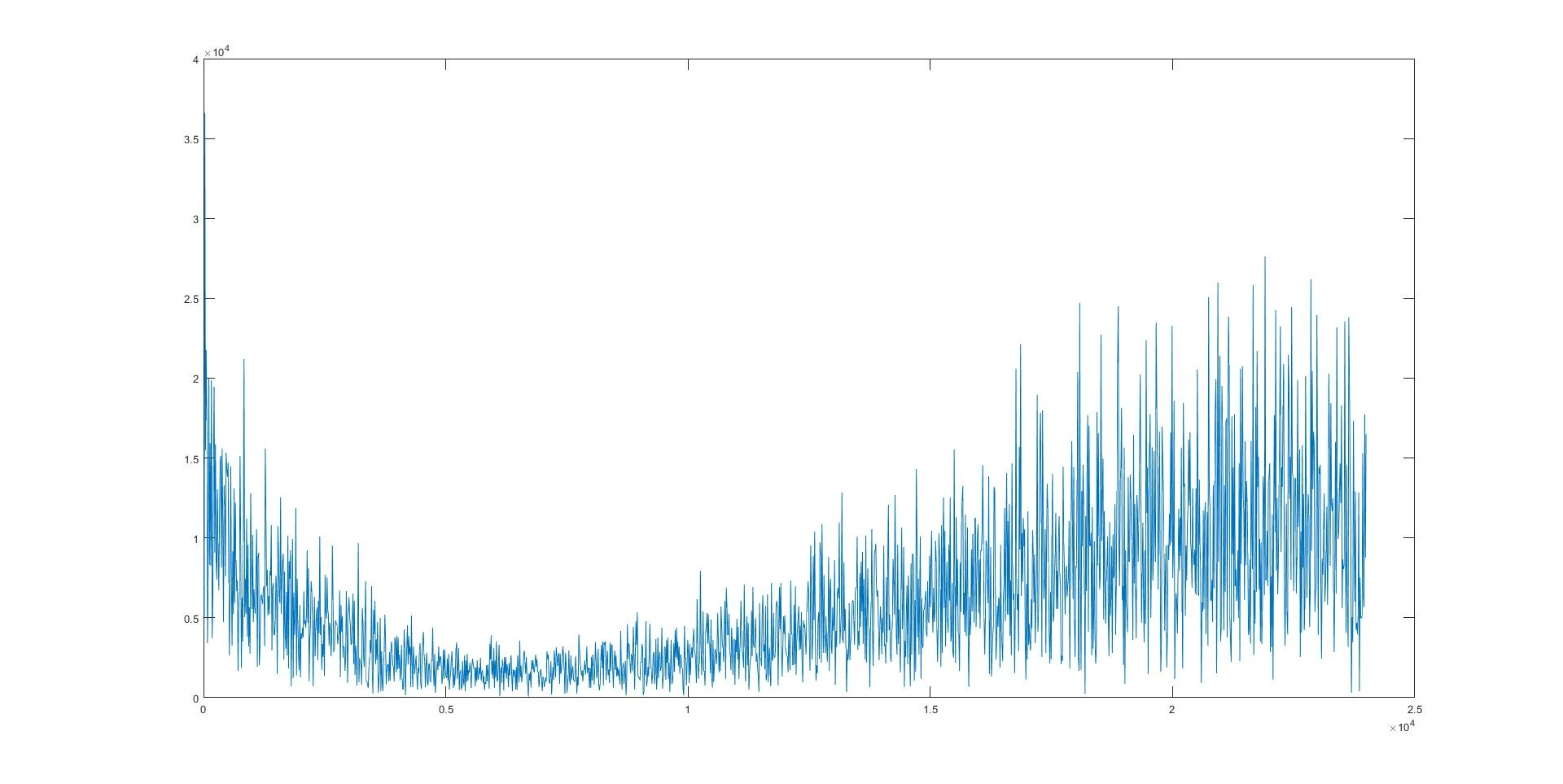

    J Lee
    August 31, 2018
    Hi, now it seems I can successfully sample audio data, below is the spectrum of 10KHz tone signal.
    However, in an acoustically quiet room, the mic can still sample high freq noise, which confused me.
    Now there are 2 things also confuse me:
    1. It seems the PDM sampling rate changes according to I2S audio freq(audio sampling rate), and PDM sampling rate/PCM sampling rate ratio seems to be a constant value, which is 32. i.e. user can not independently change PDM sampling rate and the decimation factor is fixed which is 32? So the decimation factor 64 in the sample project I don't know...
    2. In the example the output data format is uint16, however it seems int16 data type is more suitable?
    I found that decimation factor should equals to # of PDM bits/# of PCM samples
