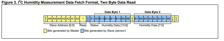

Hello. I have the following scheme for reading the output of humidity sensor that communicates via I2C:
How would I execute this sequence with STM32CubeMX IDE and HAL libraries? The output of the sensor is as follows:
All I have now is this code:
uint8_t buf[2]; // 2 bytes? how to get 14 bits?

val = ((int16_t)(buf[0] & 0x3F) << 8) | ((int16_t)buf[1] );
if (val & 0x2000) val |= 0xC000; // Sign Extend

This seems to work, although the final measurement value is a bit off from what we have in the room. Could You explain, what You did with the first line of code? Thank You very much
June 5, 2020
Humidity can't be negative. I don't think the "sign extend" line is desired.

It should be noted that these separate write+read operations put stop-start bit sequence in the middle. HAL_I2C_Mem_Read() can do a complete sequence, but it works only with memory/register addresses. HAL has those "Seq" functions - probably you can cobble it together with that crap. But all of this is ridiculous for a "high-level" library...
