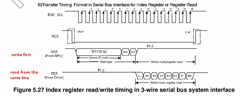

Hi all,
I'm trying to use the SPI interface of a TFT controller that uses only one line for write and read. I have the following problem:
1)First I set the SPI direction as Tx and write one byte data to the line, the clock is automatically generated.
2)Next, I use SPI_BiDirectionalLineConfig(SPI_Direction_Rx) to change direction.
3)But how am I going to read data from the same line, because the clock is not generated? Should I write something dummy to generate the clock? But the line is Rx now, and wouldn't it be meaningless to write in this mode? I really got stuck here.

    The use of throwaway writes on SPI buses is quite common, the fact the signal goes nowhere, or the device ignores it makes no difference, the purpose is to generate a clock.
