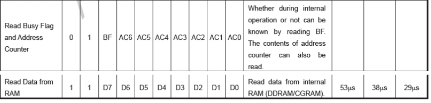

I don't understand how to use these two display modes:
Read Busy Flag and Address Counter
Read Data from RAM
Datasheet LCD2004A
I can describe how writing to DDRAM works.
First, I put the cursor on the display where I want to write the character:
LCD_SendCommand(0x02); //Return Cursor Home
And in this place I write a symbol:
LCD_SendData('F');
And I don’t understand what it does and what principle of operation for these two modes.
Read Data from RAM
I think if you tell me the algorithm of work, then I can write the code itself.
On the Internet, I could not find a description that I would understand.
JTP1Best answer
Graduate II
August 8, 2023

The display appears to have a controller similar to the classic HD44780.  The HD44780 documentation states, "When the busy flag is 1, the HD44780U is in the internal operation mode, and the next instruction will not
be accepted. When RS = 0 and R/W = 1 (Table 1), the busy flag is output to DB7. The next instruction
must be written after ensuring that the busy flag is 0."
After initialization of the display, you could check the busy flag after sending a command to make sure the controller is ready to accept data.
Often, people just ensure that there are appropriate delays between subsequent commands / sending data, like the flowchart in your data sheet shows.  Then you may not need to read from the display at all.

When you write data or command to display, display R/W pin must be low which is write mode.
If you want to read, you must somehow set R/W pin high during read operation. Check your connections where the R/W pin is connected, and try to figure out how it happens.
Then you can perform read operation, RS pin high reads data from display ram and RS pin low reads busy flag and address counter.
If you need further advice, please share your connection diagram how display is connected to MCU and maybe also code for writing to LCD.

How the bits should be set when reading, is indicated on the diagram. I understand this.
I don't understand how it's done. What is it for?
I have to specify the address on the display where the data will be read from? And data will be read from this address?
Will the display output voltage to the pins with the character code specified at this address?

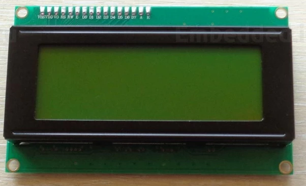

Interesting, I have a project that uses a color display (ILI9341 controller) of 320x240 pixels, and I use the reading function to print the display screen (320x240x3 bytes - RGB565). Since there are many pixels and the memory of the MCU is limited, it is easier to read the display.
But I believe that the display of this type of HD44780 controller is so simple that it doesn't seem very useful to read the display. Even most projects with this type of display even leave the Read/Write pin always configured via hardware to operate in writing mode. What is the intent of reading the display? :thinking_face:
I just want to understand how it's done. Intention - learning)

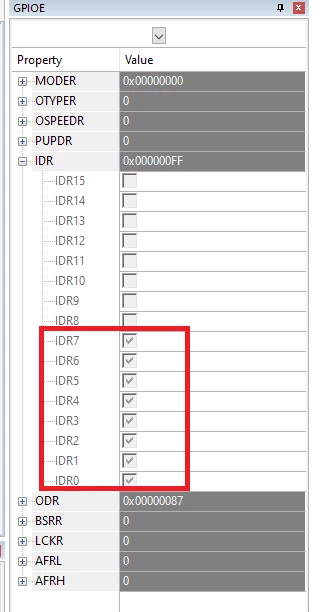

To perfrom read operation from display, you must configurate your datalines to input (use GPIOE->MODER mode register and clear relevant bits to zero) and then after reading, configurate datalines back to output by setting the same bits.
For reading the input states, use GPIOE->IDR register and read every bit and place values to variable.
Here you can see better explanation about reading GPIO pin states
https://controllerstech.com/stm32-gpio-input-configuration/
And then your controller reference manual gives exact information about registers.
BR J.T

Yes, thank you, something already happened.
The display began to give out up to 5 volts to its outputs.
As I expected it to be.
But unfortunately all the display pins from DB0 to DB7 output a logical one.
Should there be a ASCII character code on the display pins?
int main(void)
LCD_ini(); //Display initialization
uint8_t str[]={"Hello World"};
 for(uint8_t i=0; str[i]!=0; i++) //Sending "Hello World" to the display
 LCD_SendData(str[i]);
GPIOE->MODER=0; //Enable input on port E
RS(1); //Enable RS
RW(1); //Enable RW
What else is missing.
//Enabling GPIOE for output at the end of the code, I think I don't need it right now.
I think I need to add to the code what display address I want to read.
But I can't do it.
JTP1Best answer
Graduate II
August 8, 2023
Hello
yes you probably must also write read address.
But you must also add this
EN(1);
after setting RS and RW to enable display to write value to bus.
Then after reading the value set En to zero, just like in your write command or data- functions. Check display controller manual to find out correct signaling for read operation (page 8).
BR J.T
