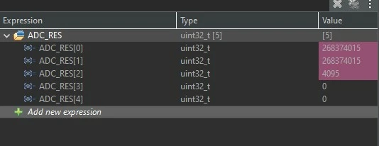

I am trying to read some data by ADC using DMA transfer method I configured the ADC
 attached the code below
I cannot getting the ADC value in all buffer only  read the 3rd  buffer
1st and second buffer shows grabage value
please help me
i tried out changing the sample value and clock prescaler

Because you defined it as uint32_t and not uint16_t.
4 replies
December 17, 2023
Your ADC buffer should be uint16_t values, not uint32_t values.
The first two buffer values are two concatenated uint16_t's
268374015 = 0x0FFF0FFF

Why the 3,4 and 5 buffers are not filled ?

Tanks worked
